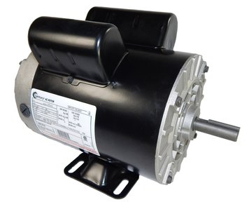

Your compressor should already have a start capacitor, most all compressors have start capacitors as part of the system....that's those Mickey Mouse ears on the motor...Circuit breakers have a time delay built in to accommodate starting motors, if you are tripping breakers you are drawing overamps for an extended period of time, or you have a weak breaker that needs to be changed out...
Sounds like you're plugging in to 15amp circuits, when you need 20amp...Have you checked the amp draw on your compressor? Should be a FLA (full load amps) rating on the electrical tag on the unit....

You can get away with the capacitors built into the single phase motor because they are only on for a second when the motor is first starting, and they are in series with an inductor (the motor windings) which mitigates these issues. Adding your own capacitors outside will do nothing but harm.
