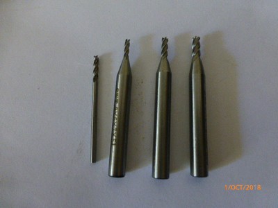

Re: Sensible slot drill size for mini mill
09/30/2018 9:08 PM
I would still go with Lyn's suggestion and then apply the profiling as required to the cut end.
It's always safer to have a small mill tool cutting on one face only - assuming that you don't apply too much force on that face, than it is to use it as a cut off tool where it is working on multiple faces at once, this puts a lot of load on the tool and will often result in breakage.
I assume you can't use a slitting saw due to the length of the piece and, being a small mill, not having a horizontal shaft.
If I really need to cut a small slot then I use a slot drill with a larger shaft as in my pics below, you can see a 2mm, 2.5mm and 3mm all with 6mm shafts and a 2mm straight cutter, it's obvious which would be stronger.
Of course you could bury the smaller one further into the collet chuck to give greater rigidity, but it makes it very hard to see what you're doing.
