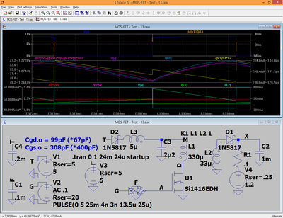

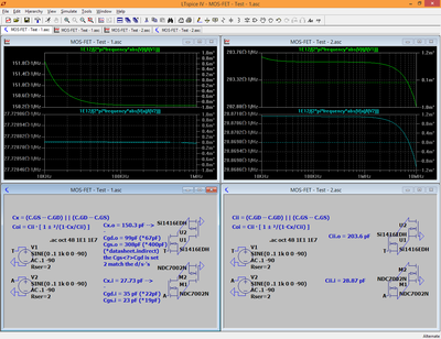

did some tests
the simulation gives tolerable timings but some **90% of simulations won't match reality + the timings tend to be (usually/**quite frequently) 900% more optimistic and (occasionally) up to ×10³ better ...
1) Quick correspondence check ::
2) turn on ::
3) turn off ::
4) apx. mode of operation :: (9ns to stop conducting , less than 70ns I/O delay . . . if so)

it's just the principal of the replacement for the prev. actual buck to test up the Advanced Battery Charging Techniques: Pulse-Charging in Large-Scale Applications - Design of Divide and Conquer Technique for High-Capacity Batteries
the commercial chargers don't want to charge or charge right the end of life NiMH-s . . .

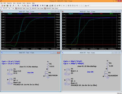

this is how much you can trust the simulators in the worst case variant example
(the only thing that differs is the geometry of the wiring - !!! the logical wiring is equvalent !!!) -- https://photos.app.goo.gl/RHL9Puwhd9AwMKFC7
ci139
Re: Any Experience with Si1416EDH 100ns Turn-off Being Realistic?
11/02/2018 10:09 AM
If you forget to include the parasitic components from board design layout in your simulation then at high speed the real world will differ from the simulation.
