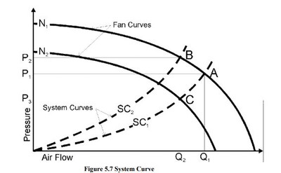

Hi Team.
I have connected two blowers in series controlled individually by VFDs. First blowers output is connected through a long duct to the second blower. Second blower output is connected to spray drier through a hot air generator. Iam facing challenges in maintaining air flow volume at the same time maintining the air velacity after second blower. request team valuable inputs and some reading materials in this regard.

There will be a pressure drop as air flows through the duct and other parts of the system. The greater the airflow, the greater the pressure drop.
https://apps.engineeringtoolbox.com/air-flow-head-loss-a_16.html
The fans have a response curve (fan curves), pressure difference vs airflow. The lower the airflow, the more the pressure difference. The rest of the system (ducts, etc) have a curve of pressure drop versus flow rate - system curve. The resultant flow rate will be the point where the fan pressure-flow curve crosses the load line. (Total pressure loss equals total pressure supplied by the fans.)
https://www.saylor.org/site/wp-content/uploads/2011/09/Chapter-3.5-Fans-Blowers.pdf
If you have insufficient airflow, you need to either reduce the pressure drop or increase the capacity of the fans so that the operating point is at higher airflow.
https://www.captiveaire.com/MANUALS/AIRSYSTEMDESIGN/DESIGNAIRSYSTEMS.HTM#Fan_Total_Pressure
http://www.sunon.com/uFiles/file/03_products/07-Technology/006.pdf
