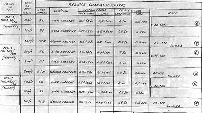

Multiple Electrical Faults at Plant in Island Mode
12/27/2018 5:39 AM
· On Nov 28, 2018 at 06:20 PM electric flash occurred in Plant-II “B Bus-bar” feeder, Transformers TML 1-3B and TML 1-1B at Substation 1.
The Plant-II feeder tripped on Differential Pilot Wire protection and transformer feeders TML 1-3B and 1-1B tripped on Buchholz relay protection.
Turbo Generator TG-701 tripped on differential protection during high through fault current.
TG-702 also tripped on differential protection during starting of cooling water pump motor MP-801C which resulted in total power failure
The electric flash in Plant-II feeder damaged Medium Voltage Cable terminations, Current transformers and associated control wiring.
The electric flash and fire in transformers TML 1-3B & 1-1B damaged windings, tap changer, transformer tank, junction boxes, instrumentation and bushings.
Can you please estimate probable reason of Fault:
Attachment: Single Line Drawing
Seq of Events and Pictures
Fault data files for Generator TG-701/702https://drive.google.com/drive/folders/15DA8Uq-zEQUUiTcOtNJ7HAYbvt9hlihn?usp=sharing

We need to investigate root cause of this cascaded failure . .
The termination of one of cables of Left most phase of Plant-II feeder had sign of flash.
The EPR insulation had crack at location near core copper screen end which caused electrical flash at Plant-II feeder.
The transformers were badly damaged but the link between termination failure and transformers failure needs to established . .

1. The 1-line diag does not show any protective circuit breakers for the secy of the transformers.
2. The tripping by Buchholt was likely caused by vaporisation of trfmr oil by unprotected high current within your trfmr secy that got them burnt. Buchholt does not protect against fault current!
3. Your trfmr secy high current can happen after Fault 1 only if somehow they are supplying the short ccted fault (the 1-line diag does not suggest any explanation) and were unable to trip because there were no protective cbr.
4. If the 1-line diag is exactly as shown, the design of the protection of your installation is suspect. Any shortcircuit fault on your services will cause your trfmrs to blow up. Your system is not protected against this failure mode because there are no cbr to do so. Knowing whether it was a squirrel or a spanner that caused Fault 1 will only help you prevent them from entering the switchboard in the future; not going to protect your trfmrs.

Fault 1 is just failure of termination of MV cable. The flash over between conductor and core copper screen . .
The detailed single line is as follow:

Would you recommend deferential protection for 1000KVA distribution transformer . . it does not appear to be economically justifiable protection

Thank you for your prompt reply, our comments are :
1) You are right. The transformer secondary side does not have a protective circuit breaker. The individual outgoing three phase motor feeders at transformer secondary have their own protection (fuses). Any fault which is at primary, secondary or anywhere upstream of the outgoing feeders is isolated through the primary side circuit breaker which has Overcurrent (51), Short Circuit (50) and Ground Fault protections (51N). We understand that a ground fault at transformer LV side will not be seen by the MV breaker ground fault protection because of the delta connection on MV side. What is the general practice for protection against ground faults at LV side with Dyn11 vector group transformers?
2) Yes. Buchholz relay probably tripped as a result of vaporization / explosion which was too slow to protect the transformer from permanent damage.

Thx for the extra info. Now i am curious: How come the fuses didnt protect the trfmrs?
One general principle: cbr/fuses only protect items above it.
Yeah, you need to find out why the fuses fail to protect the trfmr secy. Are the fuses far away from the trfmrs? If the high fault current is before the fuses, that can explain why the fuses didnt blow and the trfmr secy got fried.

Buchholz/Sudden pressure relays are the most sensitive transformer protection for oil filled transformers, they did not work as they should have.
One thing to remember about 51N relays is that due to CT saturation, you cannot reliably detect fault currents below the CT primary rating, regardless of relay setting. So a 51N relay using 600/5A CTs will not reliably trip for fault currents less than 600 amperes primary, even if set at 0.5A pickup, which you would expect to pick up on 60 amperes of fault current.
The upstream 50/51 relays need to be set to protect the transformer for through faults, typically called the ANSI point, by design to be for your Class II transformers, 25 times rated winding current (primary) for 2 seconds, your relays need to clear the fault before this. The slope of the thermal damage line is linear plotted on log-log paper, the next point is 11.3 x rated current for 10 seconds.

Sudden pressure relays ANSI 63 are the most sensitive fault protection available, so it is likely that all of the subsequent failures were a result of that catastrophic transformer failure. Usually the Bucholz relay pops and there is no other indication of damage until you TTR or hipot the windings, or test the oil. High voltages would not be unusual as a result of clearing the fault, or, as lightning, the cause of the fault.
i didn’t see single line with the protection shown, it would be unusual for anything but 2 or 3 phase over current relays on a 1000kVA transformer feeder, set to protect for through faults, and coordinate with downstream devices.
Arcing faults can appear as load, so the potential for a huge amount of damage before the protection reacts is easily possible. You need just the right conditions to cause great damage. A good thing to recognize is it takes about 400 amperes to sustain an arc at 480V. The damage from that before it devolves into a fault that can be sensed can be enormous.
If a large amount of your fault current is from local generation, that can also complicate things if the generator trips off early, or doesn’t have field forcing for the excitation to support external fault sourcing. The fact that you have pilot wire protection implies distance between components, which then can attenuate current flow under fault conditions, increasing the potential for arcing faults.

A cable shield failure is not the cause of all the damage you see, it has to be a result, most likely as a result of circuit breaker(s) opening. It would be unusual to apply surge arresters to a system you describe, except if there are long exposed sections in your primary distribution system.
I suspect that your protection you rely on for the transformers does not start to pick up, or has extremely long timing (600 seconds or more) if you experience a low level fault, likely when separated from your utility.

I find it hard to believe that the Bucholz sudden pressure relays cleared the fault, your damage of the transformers should be undetectable from the outside. The flag on the diaphragm may be showing, but it did not do the job it is designed to do., for whatever reason. Misoperation is not unheard of, so they may have been disconnected.
Also, you need to look at your relay coordination and your generator over-current protection, when your available fault current is sharply reduced, islanded. Voltage restrained overcurrent relays allow higher currents if the terminal voltage is low, to provide enough fault current to assure positive tripping of downstream protection. Remember the 400A arcing fault current, that's why the excitation and overcurrent protection is important when islanded.
