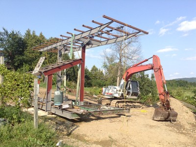

Drive Train for Turning a 40,000 lb Building
02/06/2019 10:05 AM
Hi everyone
I built a 13' by 30' Aquaponics greenhouse with a 6kw pv array above. It sits on a central 4" id tapered roller bearing and has 4 6"dia. 5,00 lb rated casters for tilt moment that roll on a 19' dia. Concrete Slab. I currently have a winch motor that I replaced the spool with a sprocket off a starter to drive a flywheel driving a car wheel that turns the building to track the sun. Just wondering if anyone in this great brain trust have any better suggestions to get some better tourqe for the snowy days?
thanks,Kurt

Okay I live in Vermont, 32f below wind chill last week your obviously visualizig a Florida greenhouse, they don't work in the north. Unless all you want to grow is kale in early and late winter or spend a huge amount of money heating it. So far it has not gotten below 60f inside
my goals were.
to generate all the power for my home and to run and HEAT a greenhouse that could produce all the warm weather crops and fish my family needs all winter long.
first yr generated 12,000 kWh. With A. 5.7 kw AC rated array. Which has satisfied the goals
reasoning behind my design. It rotates so I only need glass on 1 side , minimizing heat loss in cold weather and minimizing overheating in summer .
the Array above never shades the windows and also tracks the sun on the horizontal axis.
I planted in November, Currently tomatoes are producing along with many other things.

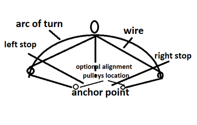

Re: Drive Train for Turning a 40,000 lb Building
02/06/2019 6:21 PM
OK I see now it's closer to 240 degrees....
This is not quite to scale and the tee connections on the shaft are exaggerated, but hopefully this shows how in each position the wire works...You've got twin pulleys feeding the winch spools to feed the wire from every angle required....and an additional pulley to guide the wire around the bearing...might still need some tweaking...

Not quite following yet, but I'll study it some more 1 note as I said to sir Robin there is only 8" between the framework and the slab so it would be difficult to install and maintain pulleys under the structure.
02/06/2019 8:59 PM
Yes hopefully this scheme could be expanded out to the perimeter, with just some wire running underneath....as the building turns it exposes the ground on the front and back, so the circle need not be more than 12 or 13 feet...
02/06/2019 9:20 PM
I've color coded wire position paths at different locations for clarity...
02/07/2019 11:36 AM
I've simplified the design a bit here....

Got it, I can see how that will turn it plenty far enough.
I'm assuming the winch and pulleys are mounted on the slab inside the radius of the 4 casters that are mounted on the corners of a 13' square so they don't run over the wires. This wil give me access to all the pulleys, anchor point and the winch without getting under it.
thanks for clarifying, I will make model and test my understanding and assess if any slack adjusters are needed and keep you posted.
I will just have to increase the clearance of the steps to clear the winch and pulleys.
best, K

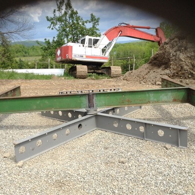

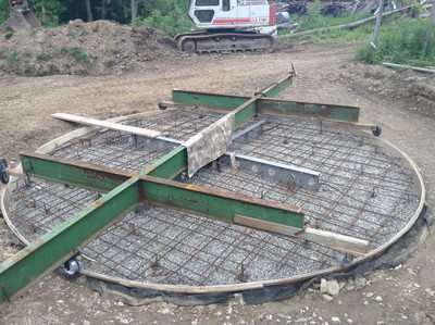

The gray 4" x 12" X 12' beam X is now in the slab along with a 12" on center grid of #4 rebar top and bottom in the smaller holes. Bearing cup on top. The green is the beginning of the floor frame.
Iron work finished.

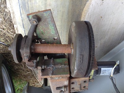

Current drive , volvo strut bottom/bearing/hub/wheel- 1-3/4" rod shaft- VW flywheel, starter sproket driven by winch motor.
after this pic was taken it was fliped over so the motor is on the out side and the wheel on the inside.
the steps are hung on the side of the steel frame just above the slab tracking in the path of the drive wheel.
are you thinking the chain would be like a track on the slab similar to a cog railroad for steep mountains?

No track, the casters discolored the epoxy coating , the slab has a slight pitch to the outside. The heating tape makes me wonder if just spraying somthing on the slab to keep the snow and ice from bonding might help. The drive tire traces a different path so it would not be effected.
thanks for the color coding of the wire routes. So I understand the sketch is not to scale but I'm not seeing how it can have much mechanical advantage, Im probably just not visualizing it correctly give me a day it will sink in.
is each colored wire depicting a different position as the building turns?
