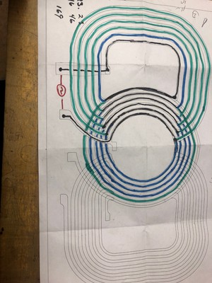

I am working on a project for wireless charging. I am trying to create a 3 coil array, but the inside coil is using the turns of outer coils also. From the design itself, there are multiple points where the coil can get shorted from because there seems to always be a shorter path. The design itself is hard to describe other than that, but what I am trying to do is only use 1 coil at a time. To do this, the other 2 coils need to see some type of resistance that is higher than the coil I am trying to use. I thought about using TRIACs or optocouplers at those points (there are about 28 points) to create opens. I can give more info if needed, but I am looking for some ideas to create opens or to see higher resistance at certain points. I am open to mechanical, electrical, or any other ideas.

If it's hard to describe, a picture (schematic) will help others understand what you are trying to do.

Like this. The black trace is the common path between the two. The blue path is the shortest. The green path is the longest. If I energize the coil on the left, I do not want any current flowing through the center coil. So in essence I need the whole left side to be blue.

I am using a patented stamped coil design. Its done by metal stamping. I have the design made already. Its just filled with shorts at about 16 different spots depending on which coil is being used.

Well then all I can see is placing switches at your short locations....You have some way of locating the position of the device, that activates the proper coil...so you will need some electronics attached to the pad at some point, and some wires feeding your switches...So what are you looking for, a controller?

Ok im on the process of figuring out what switches to use. I was thinking surface mount optocouplers or triacs. The issue is that these drawing i attached is 1 layer. Theres another mirrored layer on top of it. Im not sure which switches to use. The microprocessor logic is simple to me of which ones need to be shut off. Its just a matter of what im gonna be using to “open up” the short locations. I’m not really sure what I could do in terms of mechanical. I dont want to physically break the path due to wear and tear.

You might be finding that since the coils share a common (air) core, they are magnetically connected, in that all flux going through one must by necessity go through all the others and thus you are creating a three coil transformer.
Even if the other coils have open circuit, they will still develop voltage dependant on the current and number of turns of the energised coil.

Even with the coils separated in a normal 3 coil array, you tend to see losses in efficiency because of what you described. Any loss in efficiency won't affect us too much. I think the ferrite would help too.
