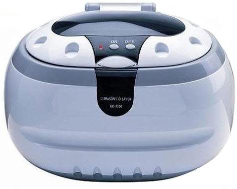

Ultrasonic cleaner was a fail in my epic past attempts.

Good to know, but in fairness you lacked the proper working fluid...if indeed we have guessed correctly...
