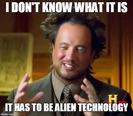

Previous in Forum: What's This?   Next in Forum: Increasing Output of Tracking Solar Panels
24 comments
Who Made It? What Is It?
03/05/2019 6:14 AM
Re: who made it? What is it?
03/05/2019 7:06 AM
Looks like a mold for making a pottery flask or bottle.The threaded piece on the end is for air pressure to expand the inside of the mold,or for spinning the mold to force the slurry against the walls of the mold.
The holes are for pouring in the clay mixture(slip) and the straw will absorb the excess moisture and will make a beautiful unique pattern in the piece when fired.
Re: who made it? What is it?
03/05/2019 11:36 PM
No.
It doesn't appear to be for making pottery I don't think that's straw in there
Re: Who Made It? What Is It?
03/05/2019 11:54 AM
Eureka! You've found it! It must be the original prototype for the very first (roadway-reflecter/Bott's-dot) ?...
Re: Who Made It? What Is It?
03/05/2019 11:45 PM
... I'm thinking of the old orange reflector powered by lantern batteries that...some foolish youthful people might snap off of their orange and white striped plywood horse to decorate their dude pad?
Re: Who Made It? What Is It?
03/05/2019 4:08 PM
Re: Who Made It? What Is It?
03/05/2019 11:46 PM
At this point.. it's All Greek to me!?!?
Re: Who Made It? What Is It?
03/05/2019 4:30 PM
It’s Fred Flintstone’s original computer mouse. Those round circles held rods that poked the little mouse inside, to make him go up/down/left/right.
Re: Who Made It? What Is It?
03/05/2019 11:47 PM
I had to read that a second time before I got a huge chuckle .
GA
Re: Who Made It? What Is It?
03/05/2019 11:00 PM
Did you find this on craigslist too ?
Re: Who Made It? What Is It?
03/05/2019 11:53 PM
.. no just this in and anvil / coffee table that I only drooled over in the hypothetical sense.
...I have since bartered for an interesting unknown anvil ..but not via Craigslist.
Right now it's just sitting out in the cold.
Too small for a coffee table.
Re: Who Made It? What Is It?
03/11/2019 8:17 AM
Anvil?Don't buy it,make your own:
https://www.instructables.com/id/Railroad-Track-Anvil/
Re: Who Made It? What Is It?
03/11/2019 9:11 AM
Railroad track anvils are anvils. I used to beat on one that's still in my dad's garage. Mine is 100kg.
Railroad anvils are a great place to begin, but unless you're a jeweler, the size and weight leaves something to be desired..
Serious Smith might say the same about my 100kg model.
The effort to make a railroad anvil have a hard flat top and a horn etc. Is seldom worth the effort as it will never have the bells and whistles of a hefty London style anvil.
Re: Who Made It? What Is It?
03/06/2019 5:38 AM
Just a WAG: what about a crown for an elephant's tooth.
Re: Who Made It? What Is It?
03/06/2019 7:02 AM
A WAG from down under. The internal cavity shape seems to be "oval" rather than round in section.
It maybe a mould for something like a glass hip flask. The fibre was probably covered with a smooth surface and the threaded bit formed an inside thread for the neck.
The threaded part could then be removed and collapse the inner shape to come out. The holes were to allow excess material to escape the mould.
Otherwise, you need some lemon juice and the original Magna Cater to find where the templar knights really hid the treasure.
Re: Who Made It? What Is It?
03/06/2019 1:17 PM
Looks like a plug of concrete with filler poured into a section of curb strip to act as a base for a stanchion or handrail. Looks like it fell out and someone donated it to a thrift store as "Art".
Re: Who Made It? What Is It?
03/07/2019 9:57 AM
Aha!
A 20,000-year-old transformer found in Kosovo
If this isn't a hoax it really is a mystery worth a lot of investigation.
Re: Who Made It? What Is It?
03/11/2019 12:08 AM
If anybody can tell what type of device used such a transformer it wold sure help??
I saw the device around the 4 minute mark while watching a video on the zany NewEarth channel of the u tube
what do you make of the "light show" in the first couple minutes?
Re: Who Made It? What Is It?
03/11/2019 11:25 AM
The ones she points to first just look like catherine wheels; the "light sabers" are a bit more puzzling.
Re: Who Made It? What Is It?
03/12/2019 9:38 PM
Very puzzling. I'd like to see more images and information. I've seen that type of sword, but not in an drawing like this.
Re: Who Made It? What Is It?
03/11/2019 5:13 AM
Hi Guys! I have the original hatchet that George Washington used to cut down the cherry tree!
The head has been replaced 5 times,and the handle has been replaced 10 times,but it is the original hatchet.
Available at a good price to serious collectors!!
I will even throw in a coin with the date 1900-BC stamped in it,so I know it is a genuine antique.
Hurry only 12 hatchets left!Only on per customer,please.
Send your credit card info to:
Dewy,Cheatum and Howe
123 EZ street
Hard Knoxville University
Confusion,Nigeria 00176-0000
Re: Who Made It? What Is It?
03/11/2019 5:16 AM
It could be a Coprolite:See the peanut?
Re: Who Made It? What Is It?
03/11/2019 8:00 AM
A coprolite encased transformer.. would be transformative..
For the record I don't agree with everything Sylvia says, but I do enjoy listening.
I don't think she does either.
Re: Who Made It? What Is It?
03/11/2019 8:13 AM
Could be! I remember Godzilla eating the power lines!
He might have used the insulators and transformers as roughage.
Carnivores need fiber too!
Re: Who Made It? What Is It?
03/11/2019 9:08 AM
Carnivores don't need roughage in their diets. They just die for different reasons.
Register to Reply 24 comments
HiTekRedNek (5); JE in Chicago (9); Jpfalt (1); Just an Engineer (1); MR. Guest (1); Randall (3); redfred (2); tonyhemet (1); Usbport (1)
Previous in Forum: What's This?   Next in Forum: Increasing Output of Tracking Solar Panels
