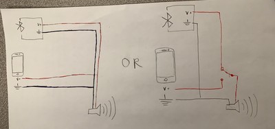

Here's a diagram of two setups (credit to Del the cat for inspiring the second one). Both diagrams are simplified to only have a single channel, but I figure that adding the other channel shouldn't be too complicated.
The one on the left was what I originally envisioned: a minimal circuit so I wouldn't have to construct a PCB, etc and could just plug in the cable and not worry about flipping any switches.
The one on the right has an SPDT (DPDT for stereo audio) installed on the V+ line so that only one source can provide current at a time. I presume that another pole for the ground channel isn't required because the circuit is already broken.
Thoughts?

Drawing on right looks good.

Don't connect two outputs together without some form of appropriate mixer, switch, buffer etc.

Definitely something like that. But once again, I don't like the idea of constantly unplugging and replugging the Bluetooth module; that's how audio channels get broken. I want to have a female 3.5mm jack on the headset that functions without physically removing the Bluetooth module. As such, could the left side circuit work just fine without frying any sound cards, or is something like the right side circuit required to ensure that no current flows between the sound cards? Again, it's simplified to be mono audio, but I believe the same principles apply.

Then you need a switch with 2 in's and one out...

Alright, took a look at the links you provided. Interesting to see from the Instructables link that DPDT will work, but would have ground interference.
The switch that you linked to definitely would work, but I'm going to try and find a version that uses a toggle switch instead, as those make troubleshooting a little bit easier. My issue with the button is that one can't tell at a glance whether it's the switch being in the wrong position or an actual circuitry failure, let alone correctly set the input source without guessing. Looking around, there don't seem to be too any easy drop-in solutions that match my spec, so I think I'll get the appropriate parts from Mouser and make my own switchboard.
