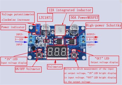

I've been meddling with supercapacitors (2 X 50F/3v. in series) and a small DC/DC Boost Converter driving various loads - 3W/6v bulb, small 6v brushed motor/propeller, 18W/6v bulb. With Vin at about 5.5v and Vout set to 6v, the currents were 0.5, 1.02 & 2.4A respectively. The converter input range is stated to be 3-35v, so below 3v it ceases to 'boost' - fair enough, understood. I measured the Vin at which the Iout & Vout starts to collapse and found it varies according to Iout. The Vin went from 3.1, 3.35 & 3.7v respectively with these different loads. This leaves too much of the supercap energy 'unconverted' to a higher voltage. Not what I expected!
These are the specs for the converter - (copied & pasted):
1. Input Voltage: 3-35V DC (Note: When input voltage is less than 4V, onboard voltmeter will not work).
2. Input Current: 9A (max).
3. Output Voltage: 3.5-35V DC (this board is boosting board, output voltage>=Input voltage).
4. Output Current: 6A (max).
5. Output Power: 65W (when the input and output voltage greater than 20V up to 100W).
6. Conversion Efficiency: 96% (the highest).
7. Output Ripple: 40mV (TYP).
8. Onboard Voltmeter Range: 4-40V.
9. Error:+/-0.1V.
So, the question is: Why?

Whenever you have a voltage regulator or voltage boost circuit, there's a voltage overhead (like a tax) that the circuit takes off the top and the rest you have to pass on to the load. For example, a 5-volt regulator requires about 7-8 volts on the input. In your case, it looks like a bit over 3 volts "overhead". The overhead increases as you draw more current, IR loss.
The capacitance of 2 x 50F capacitors in series is 25F. The energy you can store in a capacitor is E = 1/2 C V2. At 6 volts, this comes out to be E = .5 x 25 x 36 = 450 Joules. At 3 volts (where it cuts out) the energy left is E = .5 x 25 x 9 = 112.5 Joules. So you have 75% of your energy available.
The only way around this inefficiency, other than to use a circuit with a lower overhead, is to operate at a higher voltage. For example, 4 x 25 F capacitors would store the same amount of energy (450 J) as 2 x 50 F, but in series, charged to 12 v the unavailable energy would be 56.25 and 87.5% of the energy would be available.

You need to look at the datasheet for the LTC1871 along with the circuit diagram for the Converter Module #61105
You may need to reverse engineer the relevant part of the circuit diagram if it's not supplied with the board.

It's mostly in the magnetics but switch utilization plays a part as well. See the chart below for a comparison on one company's buck converter against their competition.
It doesn't matter if it is buck, boost, or buck-boost or whatever. They all look similar. Some may also roll off at the high end too.

At extremely light load the efficiency is low...the more current you draw the efficiency goes up then levels off and usually declines slowly...Look at the performance curve for your boost component....
...maybe something like this...

Yes: the units are made in china, but the heart of it is a good old Linear Tech. LTC1871, and the relevant part of the circuitry should be easy to reverse engineer.
You could even then use LTspice to eveluate its performance.

Your Vin is 5.5v and Vout is at 6v so you are only stepping up half a volt? I don't know that particular device but in my experience with DC to DC converters with that small of a difference they either didn't work or are very inefficient and unpredictable at that small difference. For all the cheap ebay devices I tested when Vin=Vout the converter didn't work at all. You might want to try stepping up to a higher voltage for your testing.
For my use I needed a stable 5v out while the input would vary from 4v to 12v and while I could find buck boost converters capable of this they were more expensive. I ended up using a step up converter to go to about 20v (could have been less) and then from the 20v a step down to go to 5v. A round about way to me indeed but it worked fine and given the cost of the converters was the least expensive solution.
