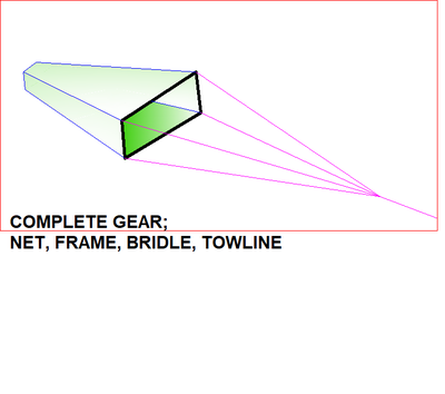

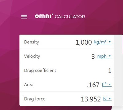

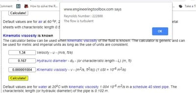

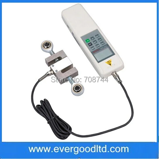

Previous in Forum: Differential Chart Calculation   Next in Forum: A Good Green Earth
14 comments
Location: Cajun Country , USA
Posts: 1498
Bollard Pull in lbs. on a Rectangular Frame
03/23/2019 9:42 PM
Question:
  • I have a rectangular frame, 12'L x 5'W x 12'L x 5'W
  • The frame is perfectly ( or as near as) Vertical, under the water.
  • The Frame is made with 2" OD aluminum Sched 40 pipe
  • Is there a way to calculate, how much Bollard pull in exerted by the frame IF it is being towed 3mph through dead calm , no current water.
Posts: 33396
Re: Bollard Pull in lbs. on a Rectangular Frame
03/24/2019 12:24 AM
Found this, has some formulas, but I think to get an accurate measurement you'll need to measure lb pull on tow lines in actual use...
https://www2.gov.scot/Uploads/Documents/Green%20No%207.pdf
Posts: 33396
Re: Bollard Pull in lbs. on a Rectangular Frame
03/24/2019 12:48 AM
What I would do is measure the drag force so that you could reverse engineer the drag coefficient of the different frame sizes...you need to know the drag coefficient for doing calculations...
Location: Cajun Country , USA
Posts: 1498
Re: Bollard Pull in lbs. on a Rectangular Frame
03/24/2019 10:32 AM
SE.
The first equation is for nets. I have that already calculated
I am hoping someone can give me the Bollard Pull for the frame only.
I have access to Load Cells, but this job requires I know the estimated BP before
I have the frame constructed.
OSHA sets limits now on maximum BP on Research vessels. . . . . so I have to have an idea of what the net and the frame will yield before we build.
Thank you for the reply.
Posts: 33396
Re: Bollard Pull in lbs. on a Rectangular Frame
03/24/2019 10:44 AM
The link contains the formula for drag....here's another
https://www.brighthubengineering.com/hydraulics-civil-engineering/58434-drag-force-for-fluid-flow-past-an-immersed-object/
Handy calculator...
https://www.omnicalculator.com/physics/drag-equation
Seawater density is about 1.0240 g/cm3 at 20°C...
The drag force can be expressed as:
Fd = cd 1/2 ρ v2 A (1)
where
Fd = drag force (N)
cd = drag coefficient
ρ = density of fluid (1.2 kg/m3 for air at NTP)
v = flow velocity (m/s)
A = characteristic frontal area of the body (m2)
The drag coefficient is a function of several parameters like shape of the body, Reynolds Number for the flow, Froude number, Mach Number and Roughness of the Surface.
https://www.engineeringtoolbox.com/drag-coefficient-d_627.html
Posts: 33396
Re: Bollard Pull in lbs. on a Rectangular Frame
03/24/2019 11:01 AM
Location: Cajun Country , USA
Posts: 1498
Re: Bollard Pull in lbs. on a Rectangular Frame
03/24/2019 1:54 PM
really nice calculator. If I were a tad bit more science inclined I could plug and play.
I'm not.
I design on my 35 years of experience with water pressure, tides, velocity , hull shape and HP.
Its not very scientific and there is probably a 25% variation but it has gotten me close enough.
Any help is appreciated in coming to a round-about poundage of Bollard Pull
Re: Bollard Pull in lbs. on a Rectangular Frame
03/24/2019 10:47 AM
The drag force is proportional to the frontal area times the coefficient of drag times the density times the velocity squared:
"Any object moving through a fluid experiences drag - the net force in the direction of flow due to pressure and shear stress forces on the surface of the object.
The drag force can be expressed as:
Fd = cd 1/2 ρ v2 A (1)
where
Fd = drag force (N)
cd = drag coefficient
ρ = density of fluid (1.2 kg/m3 for air at NTP)
v = flow velocity (m/s)
A = characteristic frontal area of the body (m2) "
https://www.engineeringtoolbox.com/drag-coefficient-d_627.html
http://scienceworld.wolfram.com/physics/CylinderDrag.html
Reynolds Number for 3 mph, 2 in dia water flow ~ 200000, CD ~1
https://www.engineeringtoolbox.com/reynolds-number-d_237.html
Posts: 33396
Re: Bollard Pull in lbs. on a Rectangular Frame
03/24/2019 12:52 PM
Can you indicate the shape and orientation of the frame as it moves through the water?
Location: Cajun Country , USA
Posts: 1498
Re: Bollard Pull in lbs. on a Rectangular Frame
03/24/2019 1:48 PM
Nothing has changed since I was last on here...I'm NOT engineered oriented.
Can I get a number?
Yes, I am too old and lazy to try to solve the equation.... not my forte.
Posts: 33396
Re: Bollard Pull in lbs. on a Rectangular Frame
03/24/2019 2:23 PM
I get about 148 lbs for the frame only at 3 mph....weight of the aluminum frame in water should be reduced by about 1/3....Weight of the aluminum pipe should be about 1.26 lbs per ft on dry land....~28 lbs in water...176 lbs total
Location: Cajun Country , USA
Posts: 1498
Re: Bollard Pull in lbs. on a Rectangular Frame
03/24/2019 2:02 PM
I have the figures on the net...however I have to add in the BP of the frame too.
Re: Bollard Pull in lbs. on a Rectangular Frame
03/24/2019 4:31 PM
Here's a calculator. I don't know how accurate it is.
I don't know exactly what 5' x 12' x 5' x 12' means, so I calculated the force for each linear foot. Frontal area = 1/6 sqft per foot. CD = 1. (See post #5).
You can multiply drag/foot by the total linear feet to get total force.
https://www.omnicalculator.com/physics/drag-equation
13.952N = 3.1365 pounds per linear foot.
Posts: 33396
Re: Bollard Pull in lbs. on a Rectangular Frame
03/24/2019 4:59 PM
I used a 1.35 drag coefficient for worst case scenario....as well as 2" ID pipe measurement....
Location: Cajun Country , USA
Posts: 1498
Re: Bollard Pull in lbs. on a Rectangular Frame
03/24/2019 8:23 PM
Thank you.
That number will give me something to start with.
Thanks again.
Register to Reply 14 comments
netmaker (5); Rixter (2); SolarEagle (7)
Previous in Forum: Differential Chart Calculation   Next in Forum: A Good Green Earth
