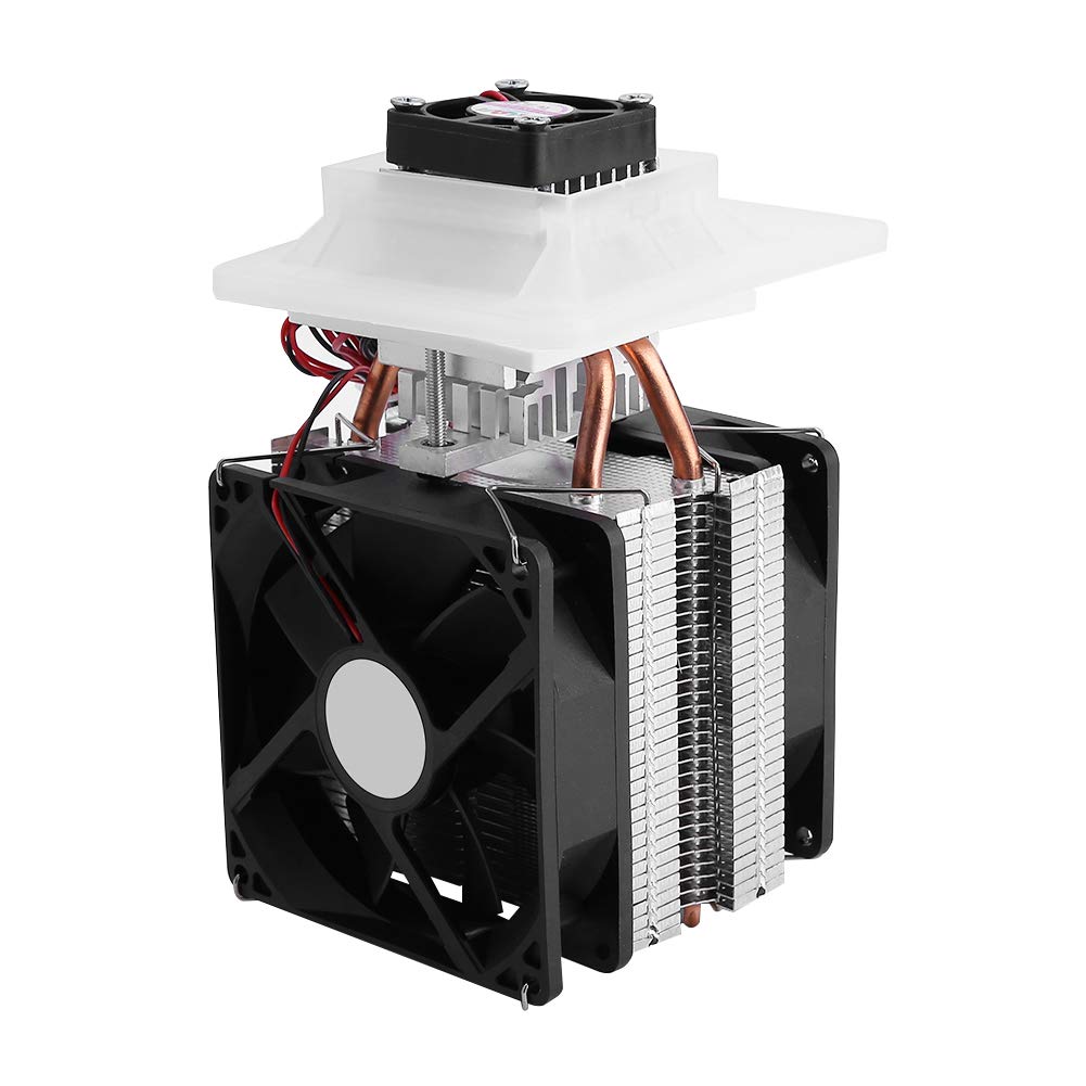

Not very efficient, not very cheap....Here's a peltier refrigeration unit for $29 to play with...

The problem is that Peltier devices are inefficient for two reasons. One reason is that it's hard to find a good electrical conductor that doesn't also conduct heat, so heat can also seep through without generating electricity. The second is that the electrical resistance generates extra heat. So the Peltier device is lossy in both directions.
Due to the inefficiency of the Peltier device, to get this to work, they had to use a superconducting coil for the inductor.
