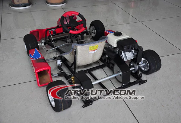

So if we wanted to add 300ft/lbs of torque for 3 seconds and we had 2 flywheel's 15kg ea and a diameter of 20cm what would the rpm's need to be ?
Re: Flywheel Battery
06/01/2019 10:44 AM
If I understand your question correctly:
300 foot pounds of torque T = 406.75 newton meters = 406.75 kg m2/s2
t = 3 sec, ΔL = T * t
Apply this torque for 3 seconds, change in angular momentum ΔL = 1220.25 kg m2/s
Assume 2-15kg solid cylinder flywheels, I = 1/2 MR2, M=30 kg, R=0.1 m, I=0.15 kg m2
ΔL = I Δω or Δω = ΔL/I = (1220.25 kg m2/s) / (0,15 kg m2) = 8135 rad/s
ΔRPM = 8135 (rad/sec) * (1 rev / 2π rad) * (60 sec/min) = 77684 RPM
Applying 300 ft lb of torque to 2 solid cylinder 15 kg flywheels for 3 seconds changes the rotation speed by 77684 RPM
06/01/2019 11:05 AM
Thank you Rixter...An extremely light vehicle of say 400 lbs with driver, could conceivably be spun up in the garage with electrical energy, and driven for quite some distance, and basically have an extremely long service life....Might be fun to try this for the dragstrip....A car that never wears out, ok almost never...
06/01/2019 11:33 AM
..."Professionally raced karts typically weigh 165 to 175 lb (75 to 79 kg), complete without driver."...
