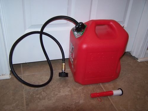

Slightly off-topic but... there are systems for adding an extra gasoline container to your existing generator tank. The original cap is modified or replaced with one which has no vent but has a tube which goes into another convenient fuel container. As the fuel level in the generator's tank drops, it makes a vacuum which sucks the fuel from the other tank. This way the generator could be ran non-stop by only refilling the aux. tank.
