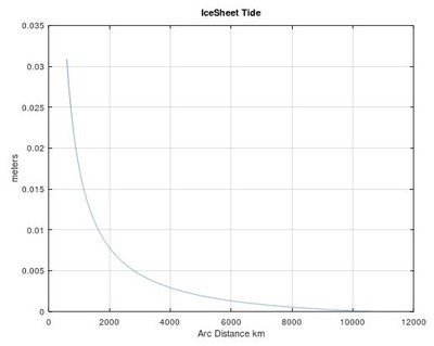

I decided to run some numbers to see the effect of the Greenland Ice sheet on the ocean level due to gravitational attraction. The ocean level defines a geoid, or a surface of equal gravitational potential, and it is always perpendicular to the force of gravitation.
https://web.viu.ca/earle/geol305/The%20Greenland%20Ice%20Sheet.pdf
The Greenland ice sheet has a volume of 2,900,000 km3, which works out as a mass of 2.9 x 1018 kg. The dimensions are 1100 km wide by 2400 km long by 2-3 km thick. The nearest ocean is approximately 600 km from the center of the ice sheet.
The technique is to pick a point on the surface of the ocean far from Greenland which we can use as a reference. Moving closer to Greenland, calculate the vertical component (g=9.8 m/sec2) and the horizontal component (a=MG/r2) at each point, where M is the mass of the Ice Sheet in kg, r is the distance in meters, and G is the gravitational constant, 6.67 x 10-11 m3/kg sec2. The slope of the Geoid will be perpendicular to that vector, so the slope is equal to a/g. This is an approximation assuming the distance is small enough to assume the earth is flat.
To be more accurate, the curvature of the earth should be considered. If the angle subtended between the Ice Sheet is Θ, the vector 'a' will be downward by an angle Θ/2, and the true distance will be the chord distance, rd.
Chord distance, rd = (C/pi)*sin(Θ/2), where C is the circumference of the earth.
The direction of the attraction of the Ice Sheet, 'a', is downward by angle Θ/2. For the slope calculation, we can replace 'a' in the numerator by a*cos(Θ/2) and add a*sin(Θ/2) to the denominator:
slope=a*cos(Θ/2) / (g+a*sin(Θ/2))
With a curved earth correction, we can calculate the amount of "gravity bump" due to the Greenland Ice Sheet:
So it appears the maximum "gravity bump" on the closest shore is about 3 cm or about an inch, the amount the ocean level would drop if the ice were gone. It's hard to estimate how much the land would rebound. It seems like a good guess would be that the weight of ice would be replaced by an equivalent weight of rock and soil after some time. The thickness of the ice sheet is 2000 - 3000 meters, so if the average rock density is ~2.5, maybe a rebound of 800 - 1200 meters, eventually. There's no guess how long that would take. But the important factor for people in Greenland would obviously be the difference between land and sea levels.
The area of all the oceans is 362 million km2. If the volume of the Greenland Ice Sheet, 2,900,000 km3, were melted, the average ocean level would rise by .008 km or 8 meters.
It seems that the "gravity bump" would be negligible compared with other changes if the Greenland Ice Sheet melted.

11/19/2019 10:23 PM
"... The nearest ocean is approximately 600 km from the center of the ice sheet. ...."
This point mass approximation throws off your estimate.
To illustrate this, just consider 1/2 the mass you used at just 300 km, and then consider just 1/4 the mass you used at just 150 km.
Greenland is somewhat rectangular so these approximations aren't too far off, but the results calculated won't make sense as the closer fraction of the mass will be shown to have a greater pull than the whole mass if point mass approximation is used when the dimensions of the mass are significant compared to the separation.
