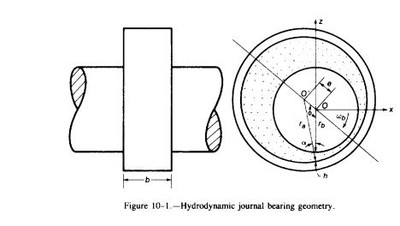

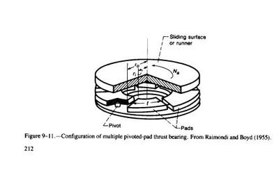

Re: Sommerfeld no
01/12/2020 5:46 PM
It's out of my field, but I'm thinking that "Sommerfeld number" only applies to journal bearings and not thrust bearings.
A journal bearing is lubricated by a layer of lubricant between the rotating shaft and the outer bearing, supported by the rotation. A corresponding thrust bearing has a series of inclined planes (pivoted-pads) that serve the same purpose. It's a different geometry, and I'm not sure the same formula can apply.
Journal Bearing
Thrust Bearing
https://ntrs.nasa.gov/archive/nasa/casi.ntrs.nasa.gov/19910021217.pdf

c = radial clearance There is no radial clearance in a thrust bearing.
What are you trying to ascertain. This may help.
