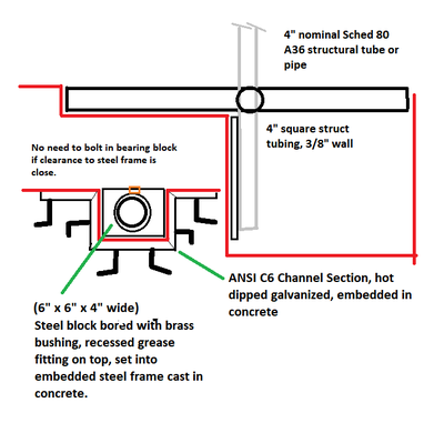

The major trouble with your concept of bollards that lay flat and lift up on a hinge is that when a vehicle hits that bollard, the hinge must take most of the force.
Assuming that you have the 3" pipe set so it is flush with the surface (it can't be much deeper, or you'd have liability problems with bicycles or feet falling into the ditch), then the center of the hinge must be 1.5" below the surface. Standard car bumpers are around 18" off the ground, so 18/3 gives the car a 6:1 lever mechanical advantage. Thus if the car exerts a force of 1000 lb (450 kgf) on the bollard, the bollard will exert roughly a 6000 lb (2700 kgf) force on the hinge.
The bollard needs to extend at least that 18" into the ground in order for the forces on the underground parts to be no larger than the forces exerted by the vehicle.
I really like SE's idea of the floating PVC bollards; they can extend well beyond 18" into the ground, and can be easily replaced when damaged. Remember that the length of the lifting pipe must be at least the exposed length plus the 18". Longer would be better.
One possible problem I see is that the bollards will tend to float up when it rains. You might find it wise to incorporate some form of latching mechanism to prevent them from lifting unexpectedly. That same latching mechanism could include a safety switch to prevent the pump from exerting excessive pressure while the bollards are latched.
