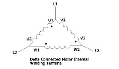

I have been working on a 75 kw air compressor that uses a star-delta starter. The unit is apx 6 years old and i'm told that pretty much from the start the unit has periodically tripped the 200 amp thermal magnetic trip breaker. Within the last month or so this unit has started tripping the breaker almost every time it starts. The peak/inrush current draw at star start is 336 amps. The starter timing is set at star for 10sec, and star-delta transition time was set for 150ms. After some research I decided to adjust the Star-Delta transition time to 75ms, my thinking was that the cause of the tripping is being caused by the voltage potential deference between the applied voltage from the delta starter versus the induced voltage in the motor. my question is how does this transition timing effect the motor/starter/breaker? just playing around with it i decided to record some readings while forcing the unit to trip. I set the transition timing to 150ms and when the delta energized there was no indication of high amp load yet the breaker would trip. And with it set to 75ms the motor transitioned through to delta with out tripping the breaker and the amp load at delta was 140 amps.

I agree that the star-delta starter is not needed but you get what you got as they say. The equipment that I'm working on is of European construction built for the American market. I have exhausted all mechanical trouble shooting avenues and assure you that as for torque load to the motor and the motor itself there is no increased load that would explain this issue. However some of the reading I've come across has developed a question that I'll be looking into in the coming days. and simple enough might just explain the cause.
The wiring for the motor needs to be verified based on what I've been reading. The motor lead configuration if not correct may but could account for higher transition residual voltage/current during the switch over from star to delta.
The above has been indicated to me conforms to an orderly configuration and would be the correct manor to wire my motor.
This illustrates a configuration that will run the motor but will generate higher transition residual voltage/current during star to delta switch over.
Thoughts?

There is a correct wiring phase arrangement for star-delta that reduces the transition, I never knew you could do it different ways until about 5 years ago. I wouldn’t vary from that. This assumes that you can verify the winding polarity, and the wiring matches.
