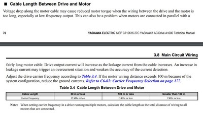

Hey friends i have a yaskawa drive A1000 has alarm OC over current and when i try to rest i am not able to.. another time when i reboot the machine alarm is gone but as soon as i put run command SC igbt shorted alarm appears and i am not able to reser it again.. please help

You think maybe the IGBT is not shorted? You might try it with the motor disconnected, but the circuit that senses a shorted output may use the motor winding current to sense the short circuit.

What are the downstream cable parameter measurements, please?
What are the motor parameter measurements, please?

Quaiser,
Any time a service tech goes to a site with a component not working, many questions will be asked. The answers are important.
--Is this a new installation or an existing one; if existing how old?
--Has anything been changed; what is the repair or maintenance history?
--Do you smell anything; is there any discoloration of parts?
--Are the cables OK; were they installed according to manufacturer's specifications; what type of cables were used?
--Are cable lengths as specified by the drive manufacturer?
--What are the drive parameters?
--Is the motor a VFD rated motor; are there any load reactors?
--What type of load and load characteristics?
--Have you tested the motor's resistance between phases and megohm resistance to ground (with the drive disconnected!)? If so, what are these readings?
--What does the drive manual say in its troubleshooting section?
We can help, but you have to be our eyes, ears, nose, etc. Let us see, hear, read, explore, and then hopefully we can help you to understand and come up with a probable solution.

well thanks for your comments and suggestion.. the drive boards have been dismantled and is under checking process.. IGBT was found shorted, checking the c.t. if there is any problem with the measurement, control boards. i think the shorted igbt may have damaged the boards also, as far the control board is ok. rest could be informed later. and hope every body is fine during this epidemic situation. take care... i will be back for your assistance thank you
Re: Yaskawa a1000 250 kw Drive
04/14/2020 7:16 AM
Equally as important as repairing or replacing <... the shorted igbt...> is isolating and removing the cause, otherwise there is a risk of recurrence. This is why the test records on the motor and its cables are still worthy of pursuit, so as to eliminate these as possibilities.
