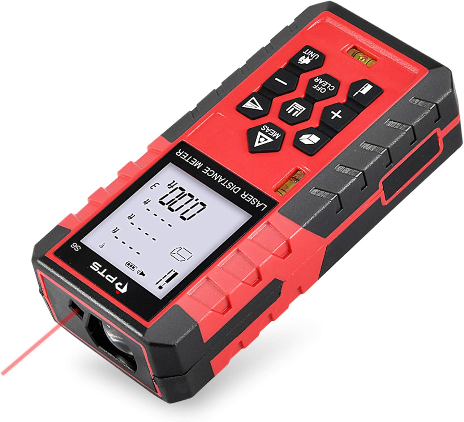

Counter Top installers use devices like this, what you need to specify is your optimal range, distance from your instrument to the target.
These mapping machines are accurate to millimeters, perhaps at long range +/- 2.5” might work, these are $6k to $9k, from what I remember the installer saying.
