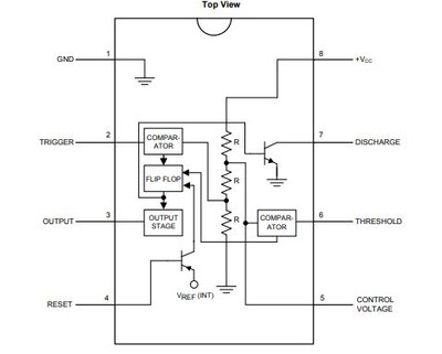

Hi,
I was trying to build an astable oscillator using an LM555 timer. In order to obtain a linear triangular wave at the capacitor, I was using two constant current path, one for charge and one for discharge. The charge and discharge currents were 5.96 and 5.92 m Amps respectively. The supply voltage was 15.0. With a 10 uF capacitor, the charge & discharge times were 8100 uS and with 1 uf & .01 uF, the timings were 760 and 75 uS (Micro seconds) respectively. When the capacitance was reduced to 0.001 uF, the charge time was 30 micro seconds and discharge time was 8 micro seconds. also, the the charge - discharge differential increased to 6 V (Instead of 5 v). Can someone give an explanation?

In a 555 timer, the output is triggered high when the trigger drops below 1/3 the supply voltage and triggered low when the threshold exceeds 2/3 the supply voltage. To generate an astable output, 2 and 6 are tied together. I assume you are charging and discharging the capacitor with two constant current sources which have almost equal currents, giving a linear ramp up and down. Apparently, this fails when the capacitor is very small resulting in a high frequency.
I'm guessing that the 555 output flip-flop switching your current sources is not symmetrical, or in other words, the rise time and fall time are unequal. At low frequencies (larger capacitor values) this results in a small error. At high frequencies (small capacitor) this results in a large error. This asymmetry could be either due to the 555 flip-flop or the constant current circuits.

Dear Guru,
You are correct. I have two separate links for charging and discharging. With a constant current of 5.96 & 5.2 mA the voltage rise and fall were linear from 5 to 10 V and 10 to 5 V. With a 0.1 uF capacitor, the timing was 75 uS. I expected the time to fall to around 7.5 with a 0.01 uF capacitor; instead, the charge time was 30 uS. The discharge time was 8 uS instead of 7.5 which is reasonable. The ramps were perfectly linear on both charge and discharge. What is puzzling me is why it took about four times longer that what it took to discharge at the same rate?.
A small oscillation (with a few mV amplitude) for about 1 uS at the beginning of the on ramp.

"with 1 uf & .01 uF, the timings were 760 and 75 uS"
Are you sure, or is that a typo: only a ten fold decrease in time for a 100 fold decrease in capacitance.
Depending on the way it's prototyped, down at 1 nF, stray capacitance may be having a significant effect.
Can you show us a circuit diagram; a picture of the physical circuit, and, any waveforms (have you got a scope?)?

Re: Charge and Discharge Timing
02/23/2021 10:01 AM
Thankan, the output on pin 7 never goes high. It only switch inside the 555 to pull pin 7 to ground, that is after all its purpose. The voltage rise on pin 7 is an exsternal action and depends on your 317 between Vcc and pin 7. The rise in Voltage on pin 7 charge the capacitor through the diode between pin 7 and 2/6. The voltage at pin 7 is also the control voltage for the 317 and the 317 need to proses the rise in voltage to adjust the voltage it clamps pin 7 at, (regulate) for sure that will add time to the rise in voltage on pin 7 and therefore the rise in voltage on pin 6/2.
Posts: 91
02/23/2021 11:34 AM
Hi Oomborrie,
I was talking about switching of pin 3, which is the totem-pole output; not the open collector pin # 7 of the IC.
Upon rising the voltage to 2/3 Vcc (10 V in my case), the discharge transistor turns ON discharging the capacitor through return branch. The function of this transistor is only to discharge the capacitor. Upon reaching the voltage at 1/3 Vcc (5V in my case) the discharge transistor turns OFF, unclamping the source (5.96 mA) allowing the current to flow to the capacitor until the voltage reaches 2/3 again. The voltage on pin 7 will always depended on the voltage on pin 6. During the charge cycle, this voltage will ride 0.7V (Which is the forward voltage of the diode) above the capacitor voltage.
There is a slight delay between the output (Pin 3) going high and un-clamping of the discharge transistor (Pin 7). The delay is only 560 nS. This delay, in my opinion should not make any appreciable difference
Another strange thing is that it did not make any difference in charge time when the charge current was increased to 10 mA.

02/27/2021 6:57 PM
Hi Anonymous/Thankan/Job,
What you observe has not been explained by anyone yet!!
I will use your diagram with numbers added to the diodes.
Suppose you have reached time just before discharge changes to charge.
  1. Pin 7 is connected to pin1 [zero volts, common] by a "single pole" switch. Pin 7 is open circuit when not connected to pin1. U2 is discharging the timing capacitor through diode 2. U1 is delivering its set current through pin 7 to common. Diode 1 is reverse biased because pins 2 & 6 are at +5 volts.
  2. When capacitor is below 5 volts, NE555 switches, pin 7 becomes open-circuit. Pin7 voltage will move positive at a rate set by the circuit capacity and sum of U1 & U2 currents. Note that U2 is still discharging the timing capacitor, so pins 2,6 will fall below 5 volts.
  3. As voltage across U2 falls its current may fall but it will still discharge the timing capacitor more before the rising voltage at pin 7 forward biases diode 1 and pin 2,6 voltage rises as expected.
