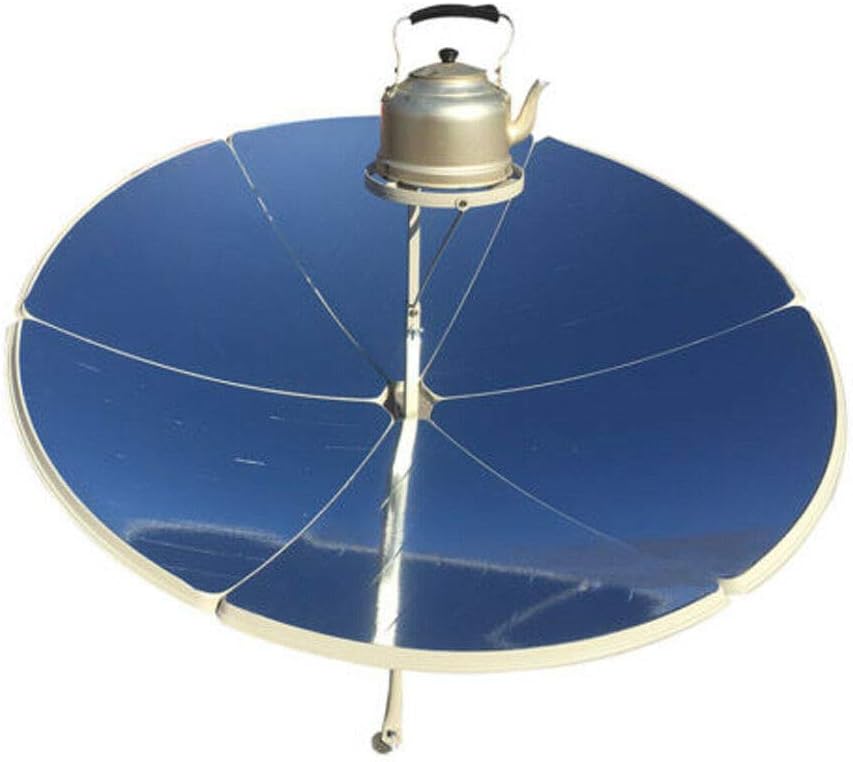

When I was younger and idealistic and not skilled enough, I tried making good solar cookers on equatorial mount. I think some of my ideas were good but I couldn't put them into practice and collaboration was pretty limited. Other people pretty much refused to work on "my" ideas, I think that using buckets and floats is a good way of moving and stabilizing big reflectors, especially if it's windy. Gusts can do damage to gears, Etc but not much they do to a float. . I think the way forward is pendulum timing of the moving of solar cookers. https://solarcooking.fandom.com/wiki/Solar_tracking contains some of my stuff and https://solarcooking.fandom.com/wiki/Ideas_for_low-tech_solar_tracking has some more. The problem was a "water clock" is not accurate enough or repeatable enough to run the timing of turning a solar reflector. I made one with a float with a hole in it and it's pretty good, just not the required accuracy when the buckets aren't perfect cylinders, (they are cone sections). But an escapement, pendulum and weight would be accurate enough. There is not need for any of the extra gears that run a clock. The weight attached to the escapement mechanism, powers the pendulum and as it drops, the float (attached to it) drops too. So it's a pretty minimal timing system. As long as we can get the weight to drop at an inch per hour or say 2 cm per hour, we can work things out so that the equatorial mount will turn evenly throughout the daylight hours. But, I looked up on Amazon and ali baba and there are no pendulum's and escapement wheels for sale. Can I DIY or is there some other solution? I did try using a battery operated clock to lower a float years ago, but they have extremely weak motors, not able to lift a small float in the water. I thought stepper motors (with say, 15 minute steps) but I haven't a clue what to buy or how to set it up. So, anyway, the thing would be very simple, just the escapement, the pendulum and the weight, (because we don't need all the gears that run clock hands. By the way, someone recently commented on one of my videos and said that one of "my" ideas was thought of almost a hundred years ago by a Portuguese priest. The video of his work (In French but you can translate with google) is pretty amazing. Here is the link
https://www.youtube.com/watch?v=jorwI9dg1g4
Suggestions appreciated, Link showing how escapements work is below. Thanks, Brian White
https://en.wikipedia.org/wiki/Escapement

Something like a low cost Arduino board controlling stepper motors and a simplistic set (possibly 4 or 5) light sensors to providing aiming information seems like the best way to go. With light sensors you possibly could use belts rather than gears since it would self-correct and not need any "absolute" position information.
Probably the best initial question is why are you trying to do this? Buckets and floats, pendulums for timing, etc. all sound rather duct tape (Rube Goldberg). Is this just a hobby? Are you trying to save the planet? Are you preparing for life after our economic system falls apart in another year or two? Is this for third world countries that don't have any way to cook? How critical is cost? How critical is weight? Is electricity available?
An equatorial mount with a stepper and gears (or belts) driving it sounds like a simple block diagram. Make it strong enough for non-hurricane and non-tornado winds and you should be good to go.
You might do better at getting help if your task is framed a little better. What is "in scope" and what is "out of scope"?
