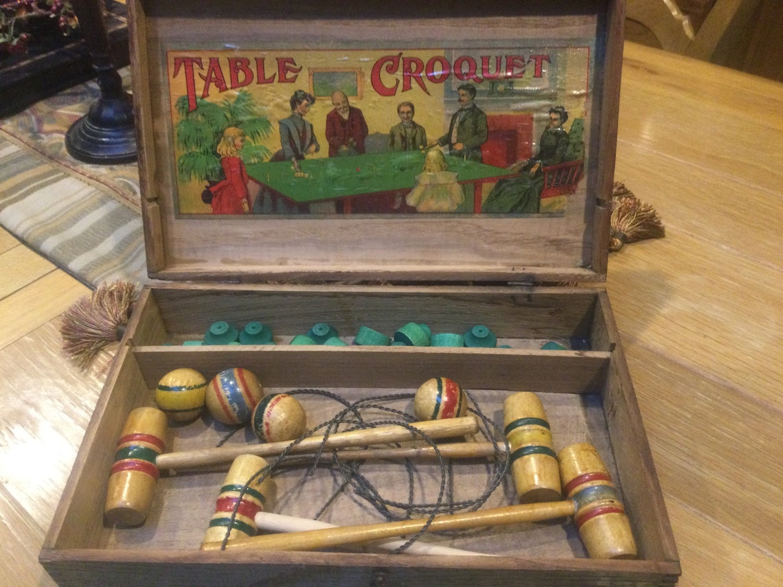

How do you measure eccentricity?
12/03/2022 8:13 AM
A full-size croquet ball is spherical and symmetrical, so on a level surface it runs in a straight line. Recently, however, I have acquired a collection of miniature croquet sets, manufactured in the 1900s by the firm which still produces items for the full-size game. All the balls of these miniature sets run in a curve, so the centres of gravity are definitely not in the centre. I emailed the firm and they put it down to the difficulty of manufacturing the balls in that era.
I don't believe this, but without sawing a ball in half it is difficult to determine the construction. However, if the centre of gravity were to be in the same place for every single ball, then one cannot blame manufacturing difficulties. The question is then how one determines the actual position of the centre of gravity within a spherical object.
Pathfinder Tags: Eccentric sphere

Thank you all. I particularly appreciated Rixter's suggestion in #3. Looking more closely at the balls, they appear to have been turned between centres, and the lack of sphericity is another reason for the erratic paths (max measured diameter 38.04 mm, min 36.63 mm)

Non-sphericity pretty much makes it impossible to analyze, but it was an interesting problem to play with.
Perhaps they were spherical when made. Wood is an anisotropic material due to the grain direction. It would be interesting if the non-sphericity and grain direction were correlated.

OP tells us miniature, this leads me to think toy size. Would a manufacturer spend a lot of effort to ensure kids game gear met the same tolerances as full size?
