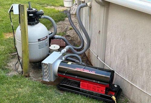

Yeah I'd go with a heat pump...or you could go with a waste oil heater or diesel heater or wood burning heater...
Re: Solar In Ground Pool Heater
02/03/2025 10:33 PM
Or a tire burning heater from TCMtech?
