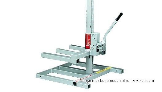

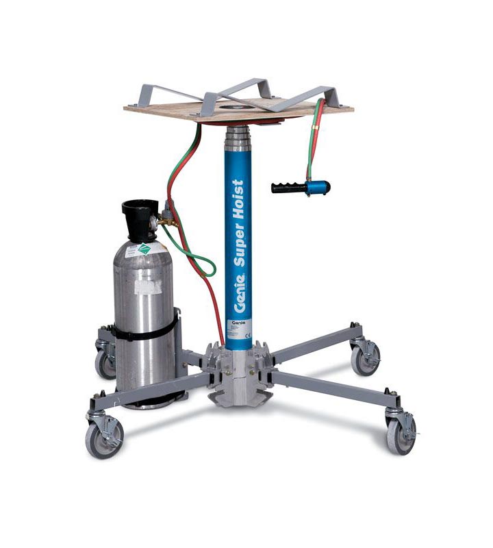

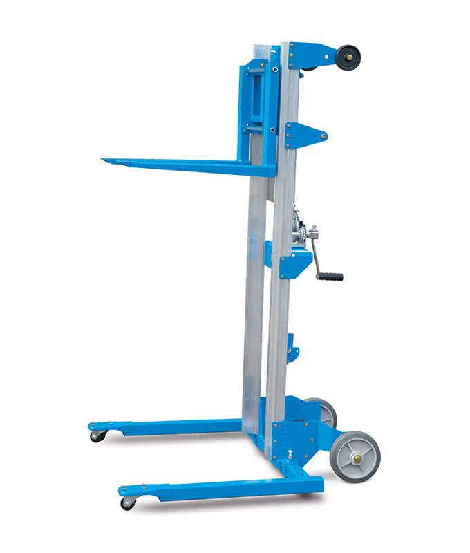

What I would use is just rent a hijack, we used to use these for getting condenser units on roofs...
...or maybe a Genie lift would be easier to handle...
These are great...

Hi Solar Eagle, nice to chat with you again! Those are nice lifts, but the feet stick out farther than the lifting arms. Can't position the TV close enough to the bracket to get it mounted. Plus, I'm into this lift for about $350.00 for the crane, the extension pole, and polyurethane wheels so as not to mar the floors of the client's house. The other lifts are much more expensive. Rental is an option, but I own this rig, and can charge for using it.
The chart you showed doesn't seem to indicate the apparent weight of objects when lifted, just the arc angle and heights. I do agree though, that a 100 lb. sand bag on the back of the crane will be helpful.
