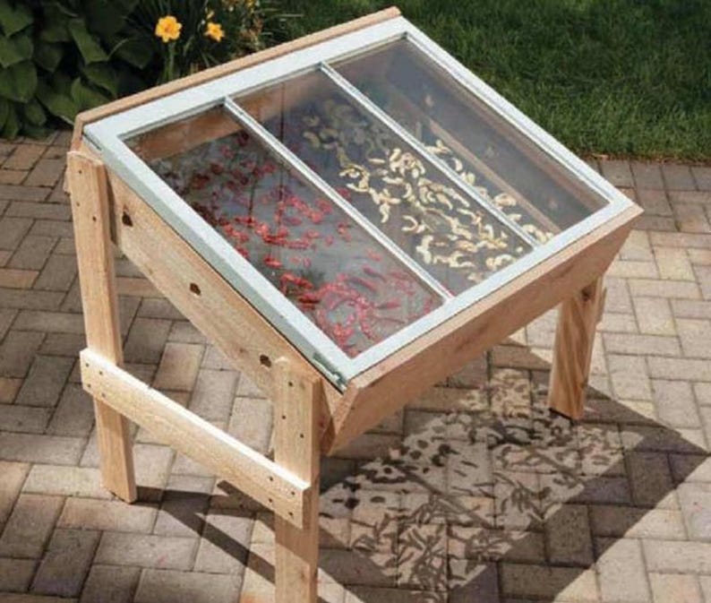

08/28/2025 9:00 AM
Why not repurpose an old storm window? They have a moveable section to expose a screen portion and one of the glass panels can be removed and replaced by screen if necessary. This would allow control over evaporation rate and temperature.
The frame that SE suggested would be a good form factor for this.
(GA,SE!)

08/28/2025 6:52 PM
A storm window doesn't track the sun, so the heat input will vary a lot over the day. Also, I have already built the thing, I am not going to throw it out, and start over afresh with something simpler that has less output. The trays have 14 1/2 inches by 17 1/2 inches of mesh. I have room for 8 but stainless steel wire for 4. No sun today, so I won't be filling the empty trays till tomorrow. The goal is to dehydrate my windfall apples, most of the plums and a bunch of green runner beans, learn stuff, and make it better. As a solar cooker, this thing could boil off 2 liters of water in a few hours when I was steaming soil. It should reasonably be expected to dry fruit and vegetables pretty quickly too.
