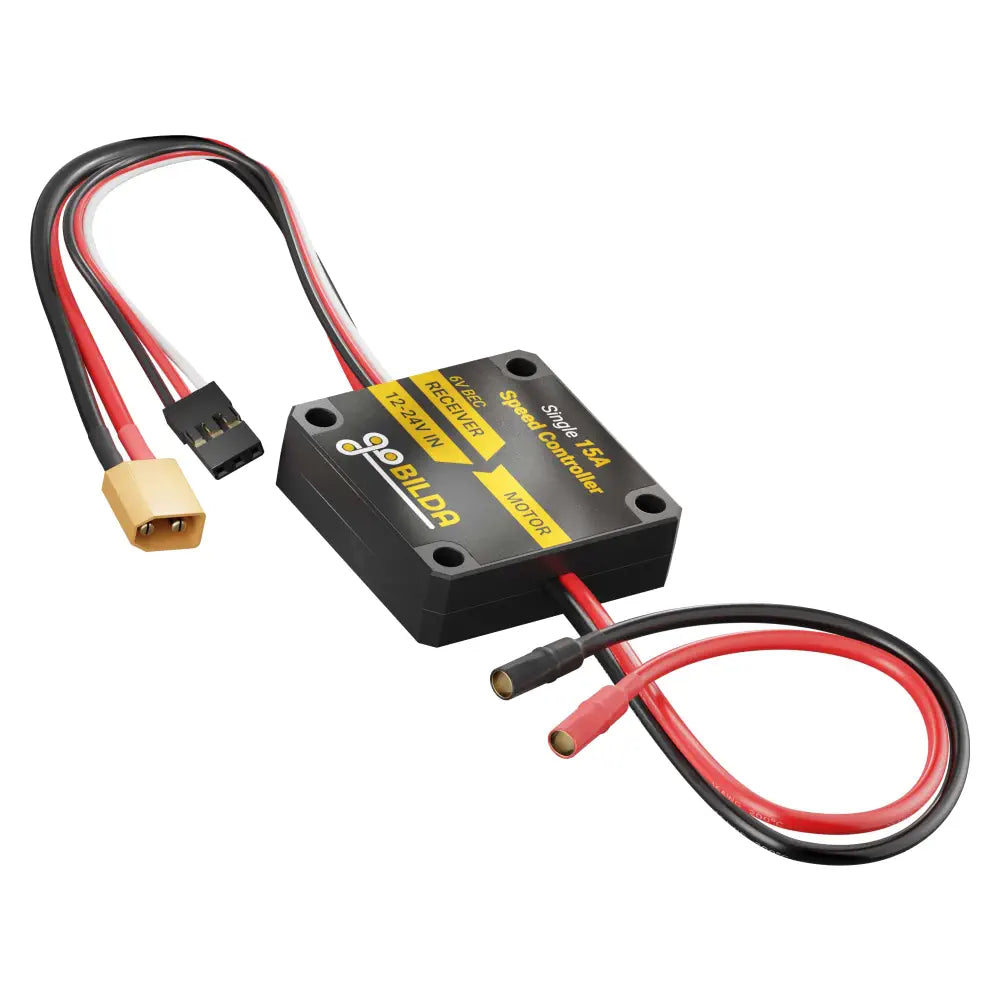

One of my concerns would be the slew rate of the actuator driving your hydraulic control valve. Is the unit going to be fast enough to mimic a human operator? The other issue that comes to mind is and some sort of feedback system. The "seat of the pants" inertial sensing system in our ears is going to be a lot more sensitive than viewing the mower from a distance. That kind of feedback is important to the control of the mower. This is an age-old problem for the operators of remote controlled vehicles.
One of the sub-sea industry specific articles on AI I saw recently and now I cannot find (), was promoting their AI pilot that controlled the vehicle following the desired inputs of the operator. They had chart overlays showing an experienced ROV operator manually piloting the vehicle on a prescribed track. It then showed how the AI-enhanced pilot installed on the same vehicle could follow the prescribed track far more accurately and without the hysteretic deviations of the manually controlled vehicle.
It seems like a remote controlled plane/car servo system should be able to get your commands to the mower. The tricky part is going to be the amplifier to take the servo signal from the controller and apply current to the electrical actuator. The trouble I was running into is that there are many electrical actuators for sale on Amazon for instance, but I could not find any with an integral displacement sensor. The displacement sensor is of course important to create the error signal of your control system.
I have not done much R/C stuff, but it looks like modern PWM controllers may be the way to go. You can get a fairly high current motor controller that looks like it would drive any of these actuators you can buy off of Amazon. This 'amplifier' will drive 15 amps, but only in one direction so you would need two of these with the appropriate blocking diodes to run the actuator in both directions.
https://www.robotshop.com/products/servocity-15a-motor-controller?qd=cd93426cc034a36e73aa209813418b5d
The RobotShop website looks like an interesting place to peruse this sort of thing.
https://www.robotshop.com/collections/wireless-rc-pwm-servo-controllers
I'm in way over my head, so I should probably stop now.
