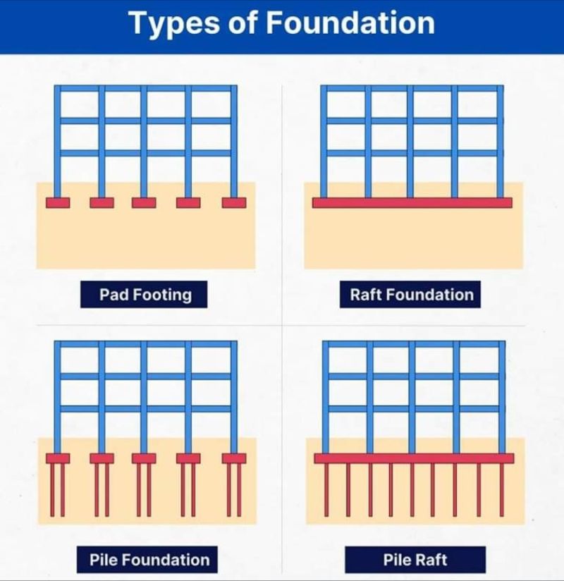

Why foundation selection matters
A raft foundation spreads loads across a larger area, which can help distribute structural loads where near-surface soil conditions are suitable.
Pile foundations, on the other hand, transfer loads deeper into the ground through mechanisms such as shaft friction and base resistance. They may be appropriate where upper soil layers are weak or where settlement requirements are particularly demanding.
In some cases, combining piles with a raft can provide additional control of settlement. However, this requires careful consideration of the interaction between the piles, raft, and surrounding soil.
There is therefore no universal foundation solution for large-scale facilities.
The right approach depends on the ground conditions, loading pattern, settlement criteria, and construction constraints of the specific project.
