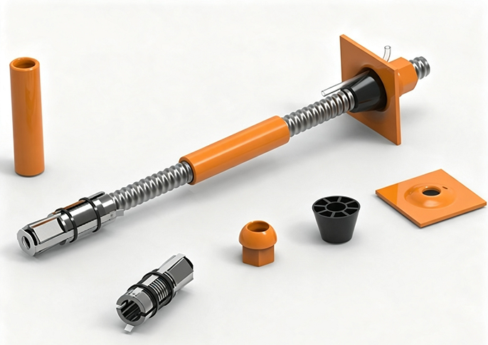

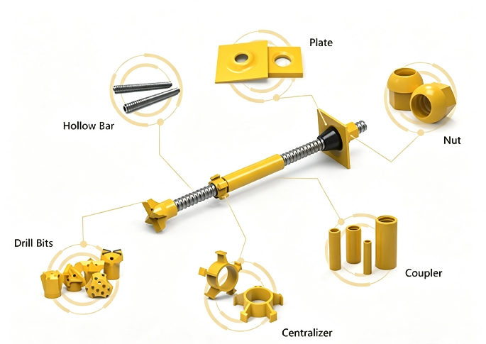

1. Installation and Drilling
The hollow anchor bar serves as both the drill rod and the reinforcement element. A sacrificial drill bit is attached to the end, allowing the anchor to be drilled directly into the rock or soil.
2. Simultaneous Grouting
Cement grout is pumped through the hollow core of the bar and exits through openings in the drill bit, filling fractures, voids, and the annular space around the anchor.

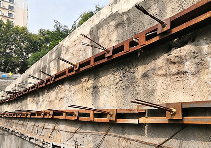

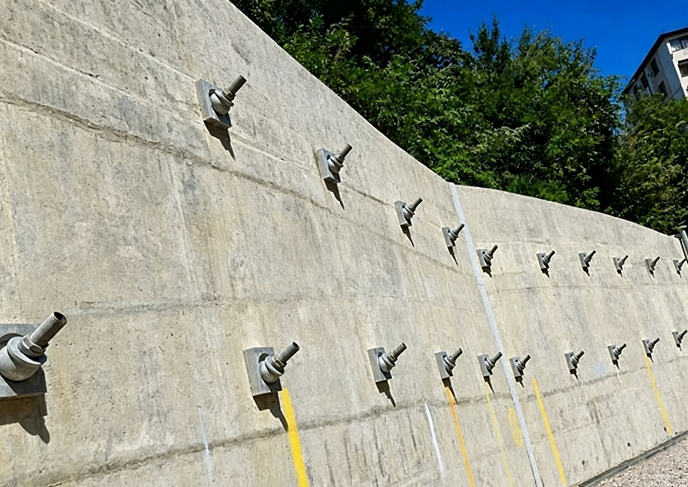

3. Application of Pre-Tension
After the grout has reached sufficient strength, a bearing plate and nut are tightened at the exposed end of the anchor.
· Applies a compressive force to the rock surface.
· Clamps fractured rock layers together.
· Increases friction along joints, bedding planes, and cracks.
· Restricts rock movement before instability develops.

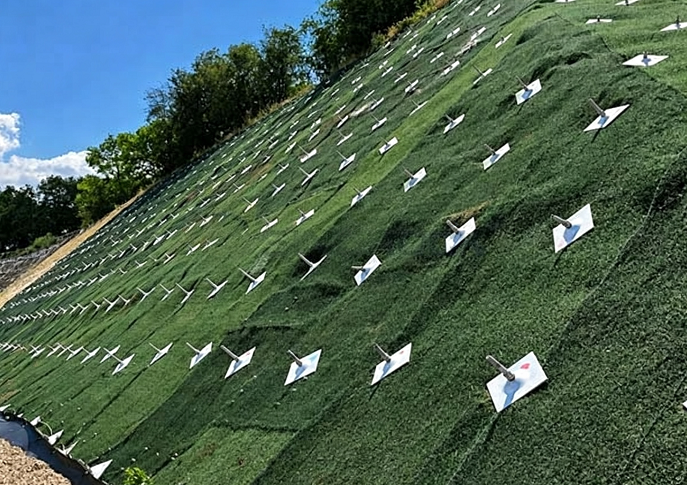

3. Slope Stabilization
Tensioned SDA anchors increase the stability of potentially unstable rock masses by improving resistance to sliding and toppling failures.
