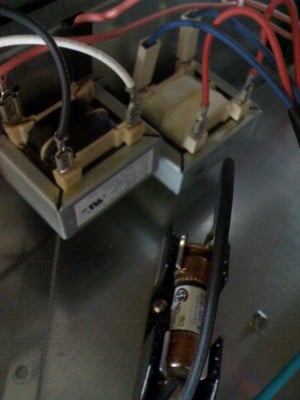

Below are some Oven component pics... The picture named "Main Filter" is kind of interesting...It has specs 275V at 50Hz...yeap 50Hz....why is that??? Also note the components on the mainboard...they say 240V on them...
Main Control-Board
Left-Light Transf., Right-Control Transf.
Upper fan
Fuse (250v-30A)
Light transformer
MAIN FILTER
Main Filter wires
Input cables
One out of the three cables from each gold screw goes through a flex pipe to the outside of the oven for power input from the wall.
When it comes to the cost of a 10KW center tapped transformer from the UK...well the last offer I got was for 400GBP shipped to Cyprus which is around $600. Not that bad considering that I might be able to power up all of my appliances!!!
Any suggestions...or comments regarding the latest updates/pictures I posted above.
I will also appreciate it if you can please answer my questions.
