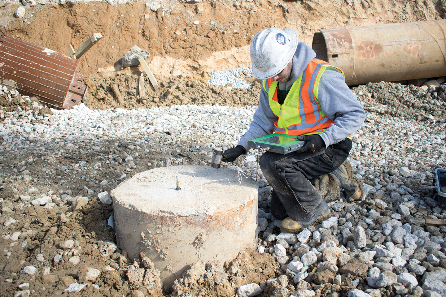

We need to measure the length of RCC piles driven to act as building foundation. The building in under construction over the pile foundation. Is there any technique to measure the length now?

Your real problem is to know the capacity of the piles. For this you can do either a static or a dynamic pile test. Static is when you put a load on the top of the pile and measure the displacements. Dynamic is when you hit the head of the pile and measure displacement. If the piles are within capacity then you should be safe. You probably have pile testing somewhere in the specification or in a reference to piling good practice. You can also consider using ultrasounds to measure the length of a pile. This is used to measure pile integrity for cast in situ piles and may be possible on your driven piles depending on the type of joint you have between pile sections (if you have sections that is).

Maybe I'm wrong, but it seems to me that there should be some way to sense the reflected energy that is bounced back from the end of the piling, since there would be, I think, some discontinuity at that point which might reflect some energy back up the column.
Maybe whacking one end with a hammer and timing the return of the acoustic energy.

Try googling integrity pile testing.

Wikipedia excerpt: "The PET system utilizes the pulse-echo method. To test a pile, the user strikes it with PET's lightweight handheld hammer. The resulting signal, or reflectogram, is captured by PET's digital accelerometer. It is than transmitted to the computer to produce information about the pile's length and shape."
The article sort of reads like an advertisement, and it certainly sounds like what OP is looking for. Well done!

go for the pile integrity test. this is easy n you can calculate the load bearing capacity by the values of the test. This will solve your problem if the foundation is safe. do not try for measuring physically. As an Engineer, we should have more concern about the safe load bearing capacity and if the structure is safe, client has to pay.

Do a PIT test ( Pile integrirty Test ) the pulse velocity changes Vs Depth and from the graph where a sudden changes the pile depth is known approximetely 95 %
