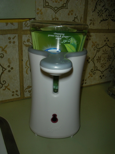

Posts: 10
Re: Orifice for Soap Dispenser/Spirit
04/18/2012 3:47 AM
Liquid Sanitizer smudges after the process.

Join Date: Jun 2008
Location: Raleigh, NC USA
Posts: 13529
04/18/2012 8:17 AM
Looks like you just need to incorporate a small cone shaped piece with a secondary orifice over your flat hole.
The spirits will be thin enough to run completely out when used, and the soap will be thick enough to stay put until the next use.
