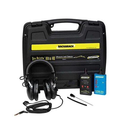

Ultrasonic...? ...recommended with extended distance cone for max amplification....vacuum leaks are the hardest to detect, especially the small ones...
http://www.sdt.eu/index.php?page=products-uld-sdt270-accessories-eds&hl=en
