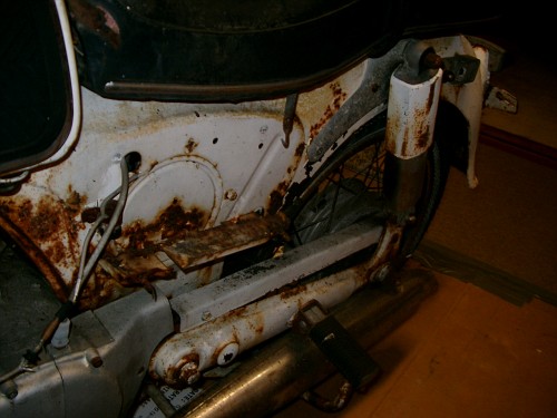

Well it's time to start the disassembly. The bike has a lot more rust then I thought it would but they always do. We'll see how it turns out as I'm not really looking to do a show room quality restoration here. My ultimate goal is to have the bike look good from 20 ft. . One major issue that will need to be addressed is the missing tab on the upper part of the frame for mounting the engine. I'll just use the remaining "tab" as a template for fabricating the new one.
On with the pictures....

I would strip the frame stampings and submerge them in a reverse electrolysis tank. It would remove the paint and stabilize the rust. You would be surprised at how well it works. Saves many hours of labor, and reduces the need for harsh chemical strippers. A must try for someone trying to save a fine old machine.

Next project I'll certainly give it a try. Right now I don't have time or $$$ to build the setup but I do have free access to a sand blast cabinet so you know how that goes.

In regards to the R.E. tanks I just don't have the space or the supplies you mentioned. I agree the investment in a trash can and cookie sheets is minimal - but I don't have either at this point but I do have a sandblast cabinet, so that's the route I'm going. You should setup a part and demonstrate how well it works to the CR4 community I'm sure a lot of people would love to see pictures of it working and your setup.

Its been a really fun project as I've never taken a bike completely apart before. I'm sure you noticed in the pictures I'm a bit pressed for space so the bike makes for a perfect winter project. (Just don't tell the landlord)

Here are some pics of the result of the reverse electrolysis process as used to strip and prep my old tractor, don't have any pics of the metal before it was painted. I'll have to take a piece of steel and let it sit in the salt for the driveway for a while, then clean it using a makeshift $5 R.E. tank. The bottom pic is the "before" shot. I took every ferrous metal part off the tractor and cleaned them all using reverse electrolysis. Not only did it neutralize and remove the rust, it also made the paint come off with little effort. No harsh chemicals and no risk of warping the metal by sandblasting. I sandblasted the fenders of an old Wheel Horse garden tractor, 0.078" thick sheet metal, when I went to reinstall them they were so distorted the mounting holes no longer lined up. Lesson learned. I will post a before and after of a bare steel plate after it has been exposed to salt.

Yeah a sand blaster will really mess-up thin sheet metal is your not careful. I look forward to your RE experiment. I guess I better go get a trash barrel and some baking soda.

Think Free. You probably have a battery charger, baking soda costs next to nothing, bleach works too. I used several different size containers, 5 gallon buckets, my utility tub, margarine tubs, a discarded kiddy pool (that one was perfect for the wheels:), any container I could get my hands on. The sheet metal was all pulled from the garbage. I never buy when I can scrounge. Besides, sandblasting is very expensive, from the media, to the massive amounts of electricity required to compress the air, it costs a lot. Current draw from the chargers is relatively low.
Few tips before you start;
1. The container will foam up from the bubbles of Oxygen and Hydrogen released by the process, so get something to skim the rust foam off with periodically or it will overflow, it stains concrete.
2. Don't use stainless sheet metal as an anode, it can release nasty chromium compounds that make the waste water poisonous.
3. Never turn off the charger while your parts are still in the tank, the process will reverse itself and you could end up harming the parts you're trying to save. If your charger has a timer don't use it or it might turn off on you.
4. Clean the parts with water and a wire brush or scotch brite pad as soon as you remove them from the tank. Then try to dry them quickly to prevent rust from forming on the fresh bare metal surfaces.
5. Use a lower amperage charger unless you're in a hurry. I left mine on over night.
6. Don't use any of your wife/girlfriends stuff in the process, it'll get ruined and so will their attitudes.

One question: I have a car battery charger that can be use to charge at 2A "slow charge" or 10A "faster charge". If I was to use this charger, do I do the 2A charge??

I would use the 2 Amp setting for smaller parts, the 10 amp setting for bigger or more corroded parts. It is really something you just have to experiment with. I have used "tanks" that were as small as a margarine tub, and as large as a kiddie pool, with different current levels and different chemicals. It is really pretty hard to screw it up once you have the basics down. #6 is important though.
