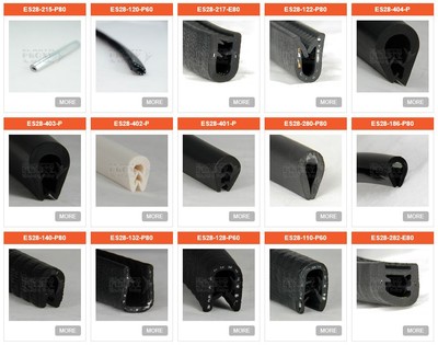

Edge Trim Dimensions
Choosing the right edge trim starts with measuring the thickness of the edge to cover. Make sure that the seal you select has the same thickness as the edge. In other words, don’t select a trim seal that’s too thick or too thin for the flange. For example, if you need to cover an edge that’s 0.125” thick, specify a trim seal with an edge thickness of 0.125” – not 0.120” or 0.130”.
Leg length is another important measurement. As a rule, shallower flanges require shorter leg lengths. If the edge that you need to cover is curved, measure and record the bend radius. Then compare this measurement to the minimum bend radius for the edge trim you’re considering. If the edge trim buckles because it can’t accommodate the radius, the trim seal may not perform properly.
Edge Trim Materials
Materials of construction are also important to consider. Select a rubber or plastic that can withstand the application environment and that resists compression set. Rubber edge trim can be made of solid, sponge, or dual durometer rubber. Bulb trim, a type of edge trim, can have a softer (lower durometer) bulb and a harder (higher durometer) retainer that’s pressed into place over the flange.
Elasto Proxy provides standard edge trim in these and other materials.
  • EPDM edge trim remains flexible at low temperatures and resists moisture and ultraviolet (UV) light. Fire-rated EPDM that meets flame, smoke, and toxicity (FST) requirements is available.
  • Neoprene edge trim provides more limited flexibility at low temperatures, but offers flame and water resistance.
  • PVC edge trim is strong, lightweight, and abrasion-resistant. It’s easy-to-install, but may crack in the cold and fade in the sunlight.
  • TPE edge trim is less likely to crack in the cold than PVC; however, TPE trim seals are more expensive.
  • Silicone edge trim provides low toxicity, low chemical reactivity, and thermal stability over a wide temperature range. Dust and other particles may adhere to silicone rubber, however.
Most edge trim is black, but you can choose trim seals in colors such as silver or white to match your larger product designs. Edge trim can have a smooth or textured (pebbled) finish, too. For additional gripping, edge trim can have interior tongues.
To help absorb impact, edge trim may contain steel wire or segmented steel cores. Steel wires are spaced apart and run parallel to the length of the legs. Segmented steel cores consist of sections that cover more surface area beneath the rubber or plastic. Because of steel’s ability to withstand impact under colder temperatures, a steel core may be required for outdoor applications such the doors on mobile equipment.
