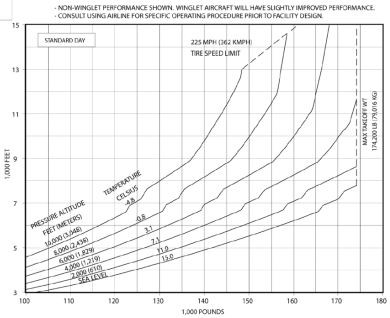

Corollary question: Does the size of the airplane affect the time of day the plane can take off? Can a smaller commercial jet -- like those that regional airlines use in the US -- take off during daylight when larger long-haul planes cannot?

Re: Night Flights: Newsletter Challenge (September 2019)
09/03/2019 8:07 PM
Good question.
"A runway of at least 6,000 ft (1,829 m) in length is usually adequate for aircraft weights below approximately 200,000 lb (90,718 kg). Larger aircraft including widebodies will usually require at least 8,000 ft (2,438 m) at sea level and somewhat more at higher altitude airports. International widebody flights, which carry substantial amounts of fuel and are therefore heavier, may also have landing requirements of 10,000 ft (3,048 m) or more and takeoff requirements of 13,000 ft (3,962 m). The Boeing 747 is considered to have the longest takeoff distance of the more common aircraft types and has set the standard for runway lengths of larger international airports."
https://en.wikipedia.org/wiki/Runway#Runway_length
The required runway length for an aircraft type is a factor of both density altitude and takeoff weight. (Airlines make more money if their planes are loaded.)
Here is a plot for the "infamous" 737-800
http://128.173.204.63/courses/cee4674/cee4674_pub/acft_run_length.pdf
