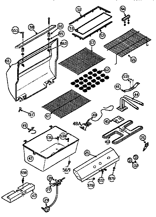

We call them Barbecue grills here and they are on wheels mostly....
Venturi tube mixes the air and gas and distributes it in the burner....

This is interesting.
That is a photo of the mixer, and it is adjustable. What is the gas source/pressure?
What does the burner look like and how are the products of combustion expelled?
Does it heat rocks or lumps of iron or a refractory or all of them...
More cool photos please.
