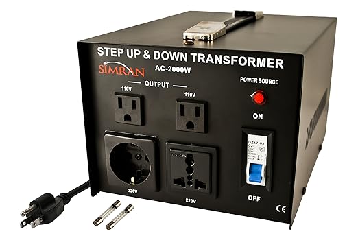

I have (and love!) an induction cooktop (hob in the UK) that runs on 240VAC 60Hz. It uses a switching type power supply, so I presume it would work nearly the same on 50Hz. 230V vs 240V should not be a problem.
...0r to say it the other way around, I suspect (but can't guarantee) that the unit made in India would work just fine here, IF it runs on single phase 230V 50Hz in India.
On the other hand, it will NOT plug in to a standard outlet. It will have to connect to a high power 240V outlet such as a dryer or electric range connection. At 2kW, you would need a very large 120-230/240 volt transformer to use it on on a standard 120V outlet. Such outlets are usually limited to 1600W-2000W, and losses in the transformer will bring the required power well above the single outlet limit..
We may also have a bit of misunderstanding on the term 'cooktop'. To me, a cooktop is a built-in unit that has several cooking areas. Mine has two induction cooking elements and two radiant cooking elements. The induction section uses 3600W.
Since the OP describes a 2kW unit, I suspect that it is a single-element unit that is portable, and normally plugs into a standard outlet in India. I also have one of those, rated at 1800W, 120V. It can only be used in outlets intended for heavy current use; it will blow a standard 20A breaker if anything else is on the same circuit.
