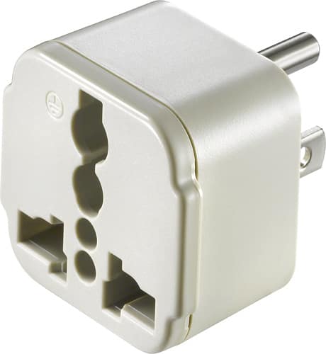

Hello,
Can I use Panasonic 47 inches with below power supply and consumption in USA.
Panasonic 47 inches TH-L47ET5D Slim HD 3D LED Television 07/10/2013 83421 Power Supply AC 110 - 240 V, 50/60 Hz
Power Consumption 137 W (Active), 0.2 W (Standby
Re: LED TV
04/11/2015 6:16 AM
Yes. The standard USA supply of 120 V 60 Hz matches the given TV specs.

The only complication you may have with this power supply is the line cord between supply and wall outlet may not have the correct plug for our outlets. You could replace the plug to your line cord or replace the line cord assembly itself with a suitable unit.

Not necessarily. A lot of electronic devices today come with universal switching power supplies that work correctly anywhere from 90-240VAC, 50/60HZ. Some of them will even work on the same range of DC voltage, so frequency is clearly not an issue with these devices.
