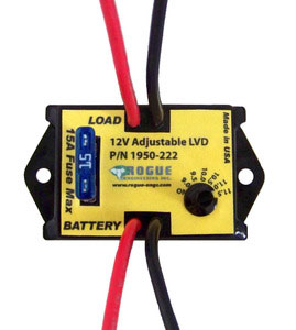

Can someone tell me the correct industry term used to describe relays used to switch power on to a device only when the voltage is within a specific range ?
I have a vehicle mounted electronic device that requires 12 VDC , and 9 VDC minimum to operate @ 7.5 amps max load.
It feeds off a secondary battery in the vehicle when parked up and i am looking for a simple cheap relay that will turn the power off to the device when battery voltage drops lower than 9 VDC.
my local industrial electronics supplier didnt know what i was referring to.
any suggestions ?

Voltage monitoring relay is one we use down here.
I am assuming you want to disconnect the electronic device before it discharges your (car?) battery flat (around 10V or below)?
Standard electrical suppliers probably wont have these, although large automotive suppliers may.

No problem except for semantics, the voltage sensitive relay is still called an isolator because it "isolates the load" from the battery when the voltage drops to a preset level.
Here's one for 15USD. Cuts off at 10V but I suspect you can tweak it (and it's better for your battery).

HRN-34 from ELKO should do it, but costs about $67 (Oz).

As Ramconsult has already correctly said (we are both assuming that its a lead acid battery), taking it as low as 9 volts (even going below 12.6 for long periods will also) damage it, slowly but surely! Some car batteries will not even last a week from new if so treated as you plan to.
If it has to be LA (Lead Acid) then it must be of a specific type that can accept deep discharges, called leisure batteries, (though some are called deep discharge I believe) they are more expensive and cannot produce the huge cranking amps for car usage that a true car battery can make, but you only need 7.5 amps anyway....
The size of the battery dictates how long it will take at 7.5 amps discharge, to get to the low voltage setting, that you haven't mentioned (at least when reading down from the top, you may have mentioned this "below" where I am, if so sorry!). You need to tell us how long it must take to get to 9 volts!!
Ramconsult has also mentioned that these battery monitors can be used for your problem. Also, some are adjustable for the drop out/in voltage.....or even build one yourself, its not difficult, with minimum electronic knowledge.
MOST important is to have some significant "Hysteresis", to prevent "Cycling".
What happens is that as the device is going off, the 7.5 amp load is removed, the voltage climbs, the device switches back on and off and on and off and on!!!
That can be deadly for many types of electronics....... I am sure you want to avoid this!!
Assuming that you have a leisure battery, assuming that the battery is required to drop off at say 9 volts, then I would set the "switch on" voltage to at least 11 volts. That will help to prevent cycling.....assuming its not a "tiny" battery of course....

Re: Voltage Sensitive Relay
05/20/2015 12:24 PM
05/20/2015 1:50 PM
That's a bit better at about $63 (Oz)

Thankyou kindly That will do me just fine . Problem solved .
