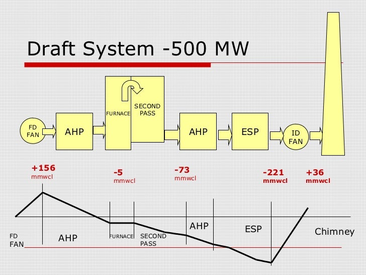

Maybe this graphic will help you understand the enormity of the scale for this process:
FD = Forced Draft, AHP = Air Handling Plenum, ESP = Electrostatic Precipatator ID Induced Draft, mmwcl = mm of water column. The boiler is around 200ft tall and hangs from steel work, it expands downward as it heats up
Note that the boiler operates at slight negative pressure that must be carefully controlled through the coordinated operation of the ID. FD, burner air, and dampers. Here's some stats:
.Yes, that's nearly 4MWs per ID fan! They represent nearly 25% of the auxiliary power consumption, another 25% goes to the BFP (Boiler Feed Pump(s)). The typical auxiliary power transformer is sized between 5-10% of the gross generator rating.
This is not small stuff:
From a SlideShare Presentation.

Too bad there isn't a "great answer" button for me to press! Nice simple graphic to show the problem.
Trade off of expensive alloys for a boiler ID fan is less pressure and stress in the boiler firebox.
