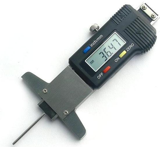

Modify the probe on something like this:
Digital tires thread depth gauge gage Thin Rod pit gauge
Join Date: Apr 2016
Posts: 4
Re: depth of micro holes
04/15/2016 6:44 AM
would be great if I could find one with a .025" pin

Make your own pin.
There are lots of digital verniers around you can select from. The pin does not need to be precision in length since you can zero on a datum surface.
04/15/2016 11:12 AM
but it will be delicate, micro drills are only a fraction in length
Location: Surrey BC Canada
Posts: 1571
Good Answers: 42
04/15/2016 3:11 PM
Use piano wire - dirt cheap.
www.grainger.com/product/GRAINGER-APPROVED-Music-Wire-15V226

If you have a depth gauge with too large a probe, you could drill out the end with a #76 (0.0200) drill and insert a 24-gauge wire (0.0201), which is a slight interference fit.
Join Date: Aug 2014
Good Answers: 225
Re: Depth of Micro Holes
04/16/2016 2:44 AM
Acquire a standard digital depth gauge (gage for some of you), modify the pin so that it enters the hole fairly easily, attach an extension spring to the top part (the bit that is opposite the pin and to the back of the gauge so that the pin is pushed all of the way down when the spring retracts.
Zero the reading with the gauge pressed down against a solid object and the end of the pin level with the base of the gauge, it will now read maximum when you lift it up.
Now simply insert the pin into the hole push the base of the gauge down against the face of the item and the correct depth will be shown on the readout.
Withdraw the gauge, the pin will reset automatically, and you can proceed to the next hole.
A half mm pin is going to be pretty fragile, so you may be wise to get one with a replaceable pin.
