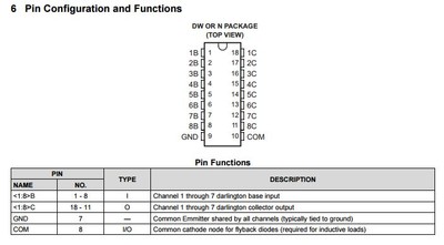

06/28/2016 7:56 PM
I am assuming this is 66 circuits that you want to invert. What is the current draw on the LEDs? You might be able to use some NPN Darlington Transistor Array ICs (8 circuits each). They will sink 500 ma. on each circuit. If your load is greater than that, you can connect more than one circuit in parallel to increase current.
http://www.ti.com/lit/ds/symlink/uln2803a.pdf
