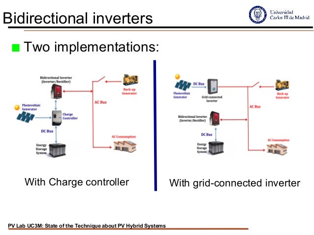

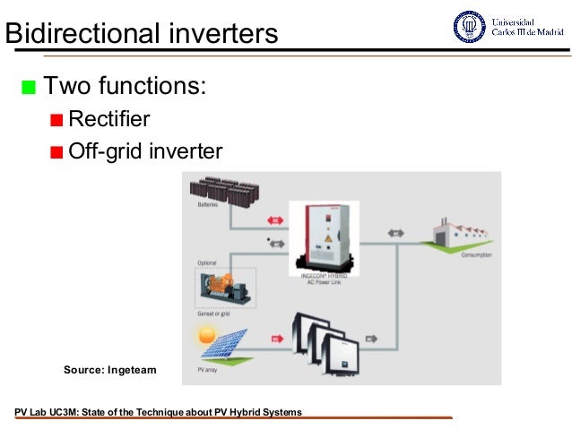

What is bidirectional Inverter in Solar PV sytem? As I understand if the sun is out and if the PV generates voltage, it charges the batteries and during winter when there is no radiance if AC supply is connected to the Inverter, it charges the batteries? Is it right?
Re: Solar Inverter
08/10/2016 2:56 PM
It can either feed charge to battery bank from grid or feed voltage to the grid from generation source(usually pv or wind)......
http://www.slideshare.net/VicenteSalas/pv-hybrid-systems-state-technique
Can be used in peak shaving...where cheaper energy is saved and then used during peak load times...
