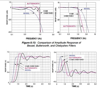

Filter design is a trade off. You will always have some ripple in the pass band, some finite rate of fall off in the transition band, and some finite rejection in the stop band. Depending on your application, you may prefer to optimize one of these qualities at the detriment of the others, and different filter designs do this. So "best" depends on your application.
Keep in mind that the closer to ideal you achieve in the frequency domain, the farther from ideal the results will be in the time domain. For example, a filter that has a sharp drop off will have a poor response to a step or an inpulse function.
http://www.analog.com/media/en/training-seminars/design-handbooks/Basic-Linear-Design/Chapter8.pdf?doc=ADA4661-2.pdf

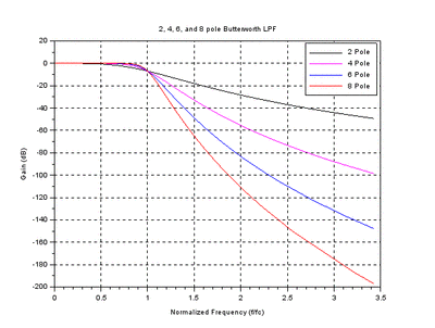

•The slope or steepness of the transition region is related to the number of poles in the transfer function of the response (next section), also known as the order of the filter.
•A pole is a root of the denominator of the transfer function. For a standard Butterworth filter every pole adds -20 dB/decade or -6 dB/octave to the slope of the response. The slope of the line is called the roll-off of the transition. Also, a pole represents one RC stage in the circuit, as shown below .
•A filter that has only one RC network is called a single-pole or order-one filter, one with two RC circuits we call it a 2-pole or second order filter, and so on.

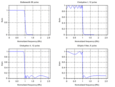

Frequency response types: There are several characteristics of filters depending on the shape of the response. Some considerations:
•The frequency response of any filter (LPF,HPF,PBF,BRF) can be designed by properly selecting the circuit components. •The characteristics of filters is defined by the shape of the frequency response curve.
•The most important response shapes are named after a researcher who studied the particular filters. •There are filter of type Butterworth, Chebyshev (types I and type II) , Elliptic (or Cauer), and Bessel, to mention the most important.
•These filter types are named after the British researcher Stephen Butterworth, the Russian mathematician Pafnuty Chebyshev, the German scientist Wilhelm Cauer, and the German mathematician Friedrich Bessel, repetitively.
•Each one of these filter types has a particular advantage in certain applications. The figure shows the characteristics of four low-pass filters, each one of four-poles and cutoff frequency of 10.
Notice the following:
1)Butterworth filter: flat passband and stopband. See figure:

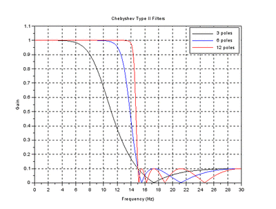

2) Chebyshev Type I: Passband has ripples, no ripples in the stopband transition steeper than Buttterworth. See figure of comparison with Butterworth:
3) Chebyshev Type II: flat passband, ripples in the stopband, transition steeper than Buttterworth. See figure:
4) Elliptic or Cauer: ripples in the passband and stopband. transition is the steepest of all. See the following figure. Shows how many poles you need in a Butterworth and Chebyshev filters to chieve the same roll-off for a 5-pole Elliptic filter. •Number of poles to achieve a 5-pole elliptic filter:
–Butterworth: 36 poles
–Chebyshev Type I and Type II: 12 poles
