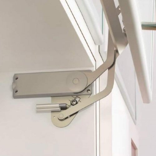

we are designing a mechanism to lift the head of a Professional vacuum cleaner up about 3-6 cm straight (perfectly vertical ). The head of the vac cleaner contains the motor and it's weight is 12-16 which makes it difficult for the user to lift the head up manually. But the problem we need to combine lifting motion with rotation motion as it should rotates after lifting.
in the link below you can check what I'm talking about and as you can see in the video it does not go up vertically. So do you guys have any suggestion to reach this movement without losing the durability ?https://www.youtube.com/watch?v=Jm5SO6gbCCA
I also included an image of the movement that we need to obtain

Perhaps the motor head mounted to a rack gear, and an actuating lever with a pinion gear. You're only talking about a couple if inches.

Extend small cleats to the right of the upper right sloped section. To the lifting handle, extend inward from each side round bars that engage the cleats once the vertical part of the lift is enough.

thanks for your answer but could you please explain what do you mean by small cleats ? or if you could draw your solution that would be really really great.
also the video does not show the exact movement that we want as we could not find the right position for the pivot point.
So the movement we want is to lift 3-6 cm up (vertically and without any tilting to the sides) and then rotating.
between the head and container there is seal and inside head there is another part attached to it which has 30cm hieght so thats the reason we need to rotate the head to take it out of the continer. I attached an image showing the inside of the tank there is a floater attached to the head with screws.

At first glance, if it were me, limited to a single pivot, I would use a rotary actuator. In lieu of that a powered slide. Weight does not appear to be an issue.
Given a better print than a concept dwg, I might be able to sketch you up a simple solution. We are not re-inventing the wheel, just tweaking it a little. On the face of things, there are two pictures, one a concept dwg, and a photo of the end product, and they are at odds with each other. It appears that the OEM is Hyundai. Is this for production, or a one off prototype?

Perhaps something like the image below.
The bracket is fixed to the removable lid with the roller attached to the body. The shape of the bracket prevents the lid from tilting until it has reached a pre-determined height set by the position of the curved section of the bracket. Once it has reached this height, the lid can then tilt backwards.
An alternative to that shown may be a pair of rollers either side of a slotted bracket.
The Teflon runner provides lower friction upon lifting.

it seems they added a bunch of pivot points to give a mechanical advantage, but unfortunately they are all in the wrong place and of the wrong length. If they were located correctly it would lift and rotate without additional parts.

Add a second lever arm parallel to the first. Add pivots to the same structures as first lever arm, leave enough gap between levers to allow the desired lift when rotated. This second lever will force the load to move parallel to the vertical support if pivot points are the same distance on each lever arm.
