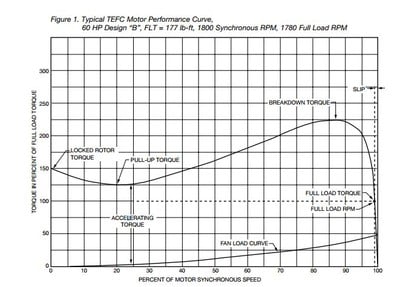

It depends more on the motor driving the fan. AC induction motors run at a narrow range of speeds, slightly slower than synchronous speed. DC motors can run over a wide range of speeds, depending on the voltage supplied to the motor.
The fan will have a airflow versus rpm curve. From this you can determine the fan's torque versus rpm curve. Likewise your motor will have a torque versus rpm curve. These two plots will cross at some speed where torque supplied by the motor equals torque required by the fan. (You can, of course, modify the torque versus speed curve of the motor by incorporating a belt and pulleys drive.)
http://www.tcf.com/docs/fan-engineering-letters/application-guide-for-selecting-ac-motors-capable-of-overcoming-fan-inertia---fe-1800.pdf?Status=Master
Bottom line: The speed at which the fan will run is the speed that the torque supplied by the motor equals the torque required by the fan.
