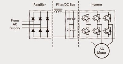

Hello,
I'm doing a motor acceleration study with one motor starting by a VFD. The result at the report is that the %Voltage at the terminal motor is higher than the %Voltage in the bus. Is this correct? Why?
Thank you!

Re: ETAP motor acceleration study
11/24/2016 3:39 PM
"AC motors are designed for a magnetic field (flux) of constant strength. The magnetic field strength is proportional to the ratio of voltage (V) to frequency (Hz), or V/Hz. But a VFD controls the motor speed by varying the frequency of the applied voltage, according to the synchronous speed equation:
N = 120*f / P
Where:
N = motor speed (RPM)
f = input voltage frequency
P = number of motor poles
V/Hz control maintains a constant ratio between voltage (V) and frequency (Hz).
Image credit: Square D
Varying the voltage frequency affects both the motor speed and the strength of the magnetic field. When the frequency is lowered (for slower motor speed), the magnetic field increases, and excessive heat is generated. When the frequency is increased (for higher motor speed), the magnetic field decreases, and lower torque is produced. In order to keep the magnetic flux constant, the V/Hz ratio must remain constant. This keeps torque production stable, regardless of frequency.
V/Hz control of a VFD drive avoids this variation in the magnetic field strength by varying the voltage along with the frequency, in order to maintain a constant V/Hz ratio. The appropriate V/Hz ratio is given by the motor’s rated voltage and frequency. For example, a motor rated for 230 V and 60 Hz will operate best at a V/Hz ratio of 3.83 at all times (230/60 = 3.83)."
http://www.designworldonline.com/faq-vhz-control-mode-ac-drives/

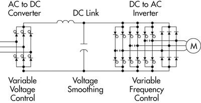

11/26/2016 5:19 AM
You state....
"At the bus there is 0.4 kV and at the motor terminal 0.399kV"
First.... what do you understand as "the bus" and in the diagram below show your test point(s) or reply with our own diagram with test points clearly marked..
Second.... why are you referring to voltage in Kv?
11/25/2016 3:58 AM
In my opinion, it depends where is located the motor side measuring point=before the VFD[point1]or after[point2]. If it was in point 2 no connection will be between the two considered voltages.
Julius
11/25/2016 4:16 AM
The measurement is at the point 2.

11/26/2016 5:48 PM
Is it possible that we are looking at a "non-problem"? I'm not familiar with ETAP, because I use a different software package. However, a VFD can output a voltage marginally above the incoming bus voltage, depending on the actual waveform. Make sure that you are using a "True RMS" reading voltmeter because of the very large amount of high-frequency noise that usually is present on the output of a VFD.
--JMM
Join Date: Oct 2012
Posts: 879
Good Answers: 42
Re: ETAP Motor Acceleration Study
11/30/2016 2:55 PM
In my opinion, even the supply voltage will be only 94% of rated[400*0.94=376 V] the VFD could
achieve 0.98*400-and even more. The d.c. voltage will be between 0.94*400*sqrt(2)=531.7 and
0.866*0.94*400*sqrt(2)=460.5 V D.C.
That means the inverter could still achieve 400 V A.C.- at least.
