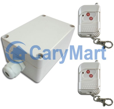

We are lifting several team members. All are teenage girls, 120 pounds or less. We have taken great care to eliminate pinch points and any possibility that fingers, hair, clothing, or anything else could come in contact with the hoist or pulleys we are using. Safety is priority one! If it isn't safe, it's not being approved by the dads for use. We also test everything on ourselves.
This prop will be used as part of the performance, and the remote has to be wireless. If it fails, we're in trouble. We will probably keep the wired remote for safety reasons, but it cannot be used during the performance.
We are using a hoist we purchased from Harbor Freight.
The wireless remote must have two buttons - one for up and one for down. We need them to be momentary, so that the hoist moves when the buttons are pressed and stops when they are released.
I found the this controller, which we are looking into a little further.

You do need a plan for unexpected movement, as it is possible that once starting up or down, the signal to stop movement may not work, for many reasons, even within the hoist controls, not including the wireless component of the control.

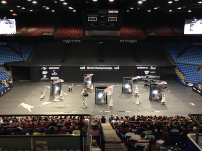

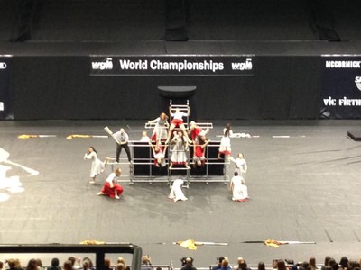

If only we had a budget for this, or were on a stage (we're on a gym floor). We also only have 45 seconds to get our prop through a standard 36" wide door, in place on the floor and fully setup and 45 seconds to tear down and get out a 36" wide door at the end of the performance. He team is assessed penalty points for every second the setup, performance and tear down exceed the time limit of 10 minutes. The performance itself is about 8 1/2 minutes.
The last thing I expected to use my engineering skills degree for was my daughters' extracurricular high school sport. Here is what we built the past couple of years. They didn't use electricity, but some of them were on casters and got moved around during the performance.
2015
2016
